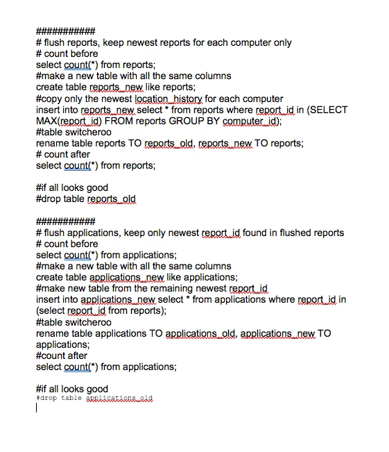

  • February 22, 2018
Hey all..
It's defintely the "Applications" table thats screwing everyhting up!!
I went ahead and truncated it and I successfully backed up the daytabase sharpish!
On further inspection, the 'mac_app_store' field is the culprit.
I 'zeroed' it 2 days ago and it's now showing a count of , wait for it, 4 million 213 tousand and 953!
It keeps adding records that contain NO data!
Log flushing does NOT help!
There is a way to keep only the last entries, which I have attached.
I have logged a support call for this and I'll keep this thread updated.
