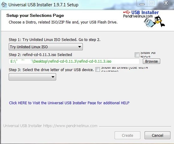

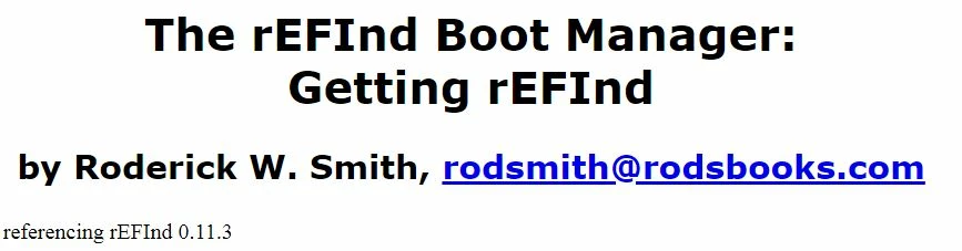

2] (I did this part on my windows machine) On the second USB stick you create a bootable USB with rEFInd boot software . At this web site http://www.rodsbooks.com/refind/getting.html download the "A CD-R image file", not the USB version. This is an ISO file. Next you need a USB maker, I used Universal-USB-Installer-1.9.7.7.exe which I downloaded from Cnet Downloads. Run the USB installer, at the main window for Step 1 there is a drop down menu with lots of Linux choices, scroll to the bottom and choose "Try unlisted Linux ISO". In Step 2 point to your fEFInd iso file. Then select your usb drive and click Create. During the process the installer said it failed and would not be bootable, but I finished it anyway and the USB fEFInd stick worked.

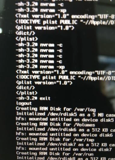

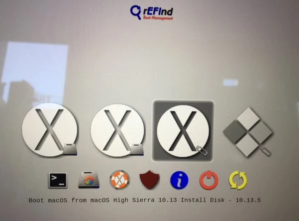

3] Go back to your Mac, plug in both USB sticks and boot holding the Option key down. Enter your firmware code at the lock screen. Then select the EFI boot USB stick and boot to that. Then using the arrow keys select the mac OS USB installer that you made. (see screen shots below) Once that is highlighted, hit the F2 key. This will give you another boot options menu. Select "Boot macos in Singer User Mode". Your mac will start booting to a terminal or command line window. Wait until it has finished scrolling out many lines of startup data, and you are at a command prompt. Then type in this succession of commands:
nvram -c
nvram -xp
nvram -c
nvram -c
nvram -c
nvram -c
nvram -xp
Yes you need to clear the nvram several times in a row! (nvram -xp just lists what is in nvram)

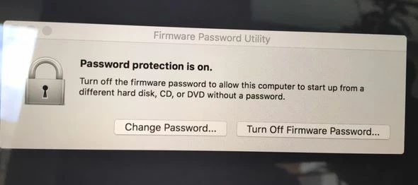

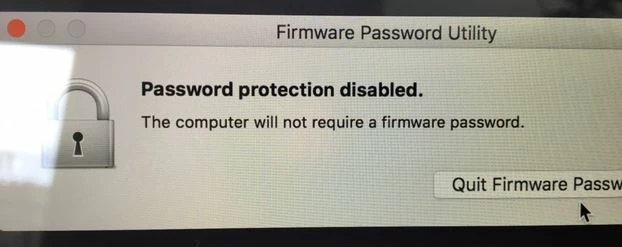

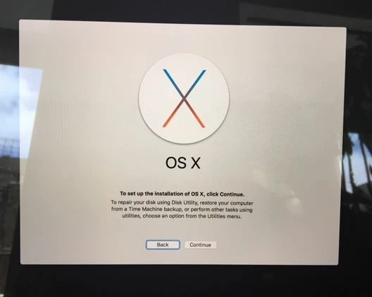

Then type in exit and wait. The laptop should continue booting in that command window until it switches over to the GUI window and you end up at the general OS Installer window. The installer window for El Capitan and High Sierra have a utilities section and the Firmware Password Utility is included. The window using High Sierra calls it the Startup Security Utility. I opened the utility and turned off the firmware authentication using the code ... [at this point I was totally psyched, as you will be, because I had been working on this for several days, including multiple calls to Apple where they told me I had to come in with my proof of purchase (which I did not have anymore for this 2015 mac passed end of warranty, sokeep your receipts!) if I wanted them to clear the Disabled Computer issue.

Here are some screen shots from the process:

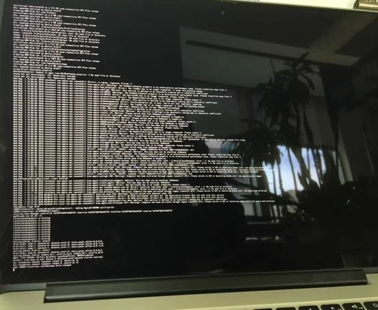

I tried the "Boot macOS in Singer User Mode" option but the terminal codes don't end, it becomes like the screenshot below. Any suggestions to fix it?
Hello everyone,
Thanks for the solution,
@toaufik I also received the symbol you received with High Sierra and Mojave installer USB sticks on a MacBook Air 13" (Early 2015).
