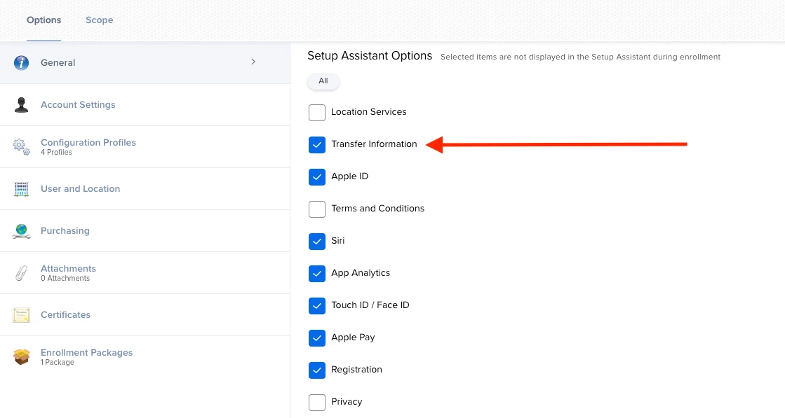

Hi,
Have you disabled 'Transfer Information' from showing up in your DEP prestage enrolment in Jamf Pro?
This is the only way I know of to supress that page.

@user-faWBxyKMJD What @snowfox posted is how to disable Migration Assistant when going through the Setup Assistant, but only if your users aren't disabling network access to bypass the Remote Management screen of Setup Assistant. If they do that they're probably using the command sudo profiles renew -type enrollment to trigger enrollment after they finish migration. You might want to take an extreme approach like sending a Lock command (if you're not talking M1 Macs that is) with message that you're going to issue a Remote Wipe command every time the user tries to bypass your DEP process.

Thanks for the input!
