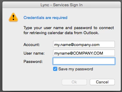

For the record, I've attached a screenshot of what the second login window looks like for those who may not know what I'm talking about. I've obfuscated the specifics but left the overall format.

I came across this as well when 14.0.10 was released. Here is my fix I sent out to users (modified for a more general audience).
The Lync 2011 for Mac 14.0.10 update is causing an issue for some people where it will always bring up a second login prompt. To prevent it from prompting for login credentials a second time you must login at the main window using username@company.com in the User ID field. See the screenshot below.If you sign in at the main window with just your username in the User ID field it will login to Lync successfully, but it will fail to connect to your Exchange Calendar and prompt for credentials a second time. The second login prompt will only accept username@company.com in the Username field.
If you just use your username at the second prompt it will fail and repeatedly display this prompt. To further confuse the matter this second login window has "Save my password" checked by default so if you attempt to login with just a username it will save the incorrect login credentials in your Keychain. Any future login attempts with the correct Username of username@company.com and "Save my password" checked may not properly replace the incorrect credentials already saved in the Keychain causing this second prompt to always display with the incorrect Username when opening Lync. If you have this issue this can be fixed by completely quitting out of Lync and deleting the saved credentials out of the Keychain. To do this open Keychain Access (located in /Applications/Utilities/), type Lync in the search field and delete ALL Microsoft Lync entries of the kind "application password".
Once these entries are deleted open Lync again and sign in at the main window using username@company.com as the User ID and you will no longer get the second login prompt. If you check the "Remember my password" box here it will save the correct credentials to your Keychain.

The main window in Lync has always allowed the use of both userid@domain.com and just userid for the User ID field. While the 14.0.10 update still allows this it will no longer allow login to Exchange this way and will bring up a separate "Lync - Services Sign In" window to re-enter your Exchange credentials. This second login prompt will ONLY allow userid@domain.com. So far not a huge deal as this can be corrected by using userid@domain.com in the User ID field of the main login window. The bug happens with how these two login prompts deal with the Keychain. Depending on what you enter for a username you can end up in a state where the second login prompt will always come up when opening Lync and ALWAYS have the incorrect username filled in. To get it into this state you must sign in at the Main window using just your userid in the User ID field and check the "Remember my password" box. Notice that when you look at the keychain entry in Keychain Access it saves it with the Account of userid@domain.com NOT just userid as entered in the main login window. Now the second login prompt will be displayed with the "Save my password" box checked by default. If the user incorrectly logs in with just the userid here it will save a SECOND entry in the Keychain. This entry will have the Account of userid. Because userid@domain.com wasn't entered it will display the second login prompt again. If the user then correctly re-enters their credentials using userid@domain.com with the "Save my password" box still checked it will update the FIRST entry created in the Keychain by the Main login window because it matches the account of userid@domain.com. This leaves an orphaned entry in the Keychain with the account of just userid. Because of this from now on every time Lync is opened it will always display the second login window with the incorrect UserID even if you are automatically logged in at the main login screen because the credentials were previously saved to the Keychain. There are three primary bugs here: 1) When the Main login window saves the credentials in the Keychain it does not correctly save what you have typed in the User ID field. It appears to save the email address instead. 2) At the second login screen it saves the entry to the Keychain without first verifying the credentials are correct. It is also in bad form to have the "Save my password" box checked by default especially when it saves incorrect credentials to the Keychain. 3) This issue did not appear in previous versions of the Lync client so whatever changed to require a full userid@domain.com to access Exchange should also be required at the main login window. This alone would make it impossible to get into this state if you started using Lync with 14.0.10 but it may still be possible to get into this state if you are upgrading from a previous version. This issue is 100% repeatable.
