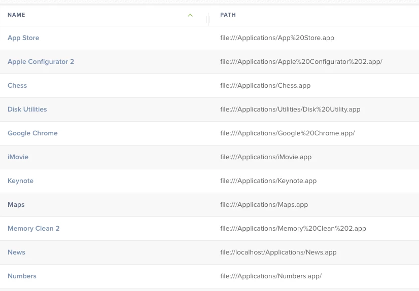

When I use this as you suggest, Macintosh HD/System/Applications/Safari.app disappears off the dock.
If I use file:///Applications/Safari.app/ It appears on the dock.
However, that same formal does not work for Maps, System Preferences or Chess. see attachment
  • November 20, 2019

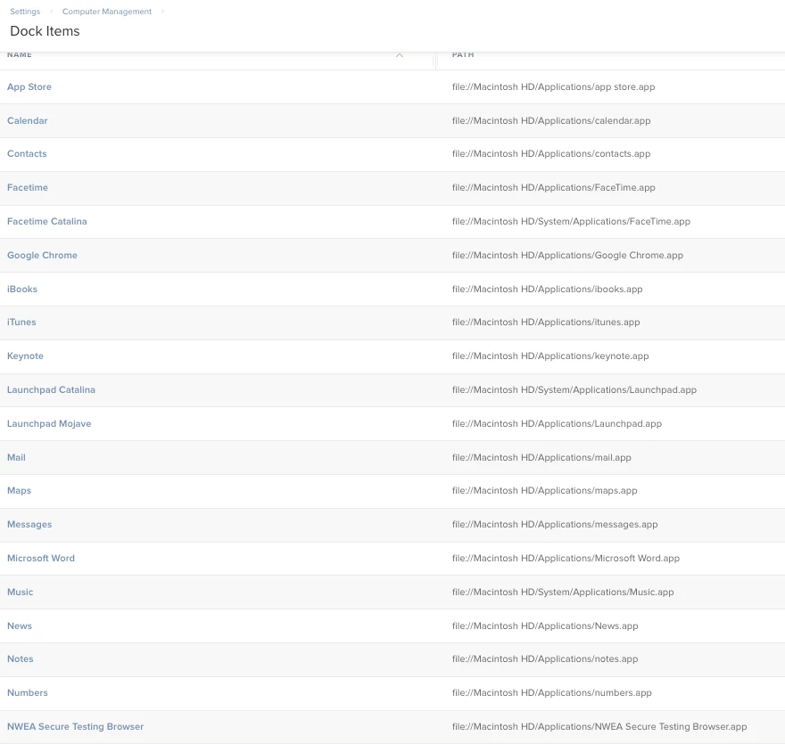

You've got an extra slash in there. Here's an example of my Dock Items
Its file:// NOT file:///
All mine work, Catalina, Mojave, doesn't matter.

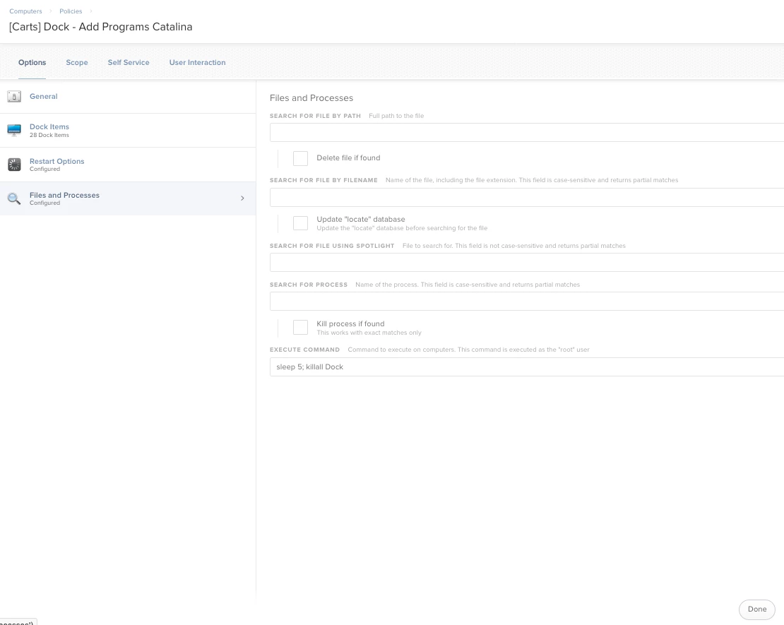

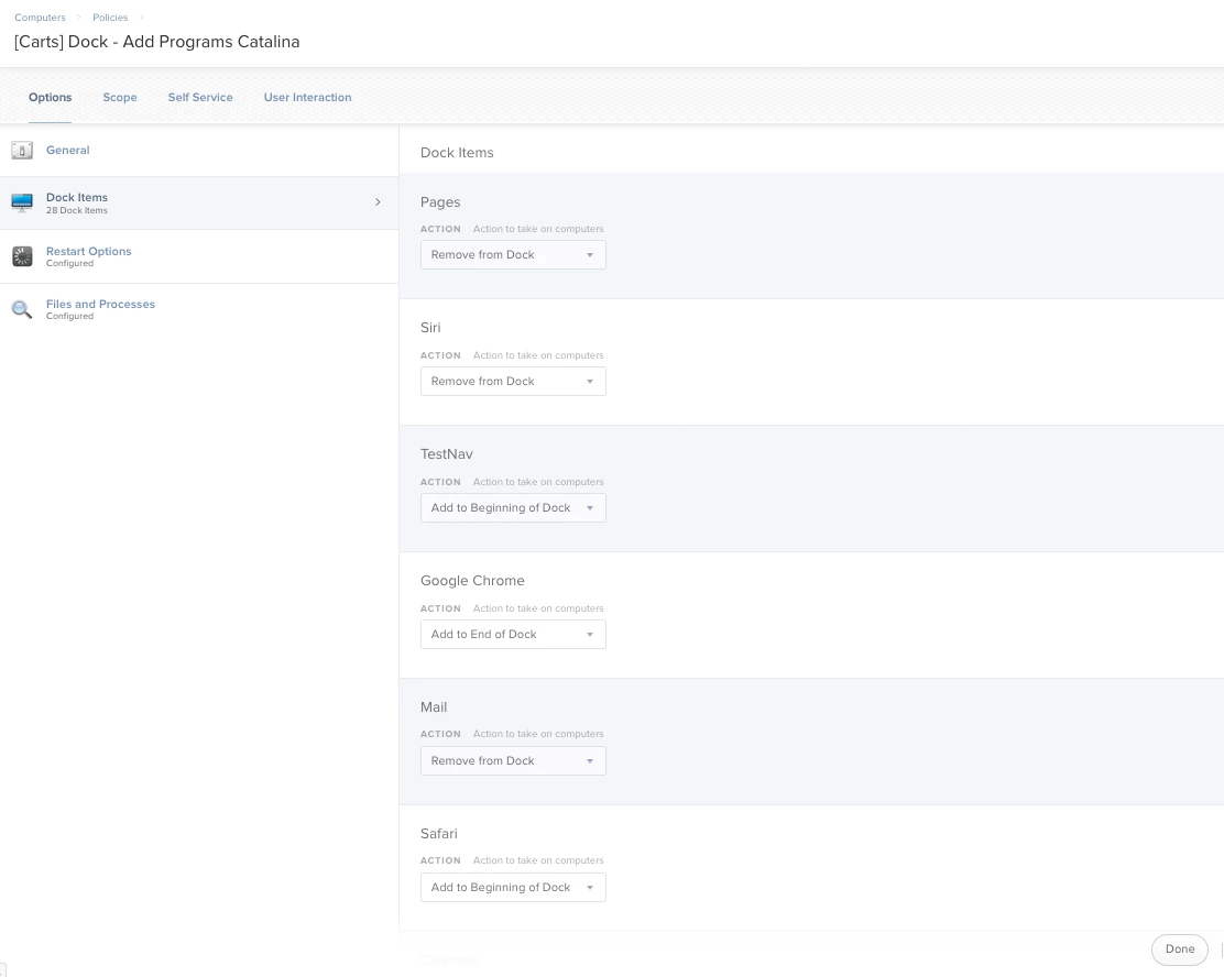

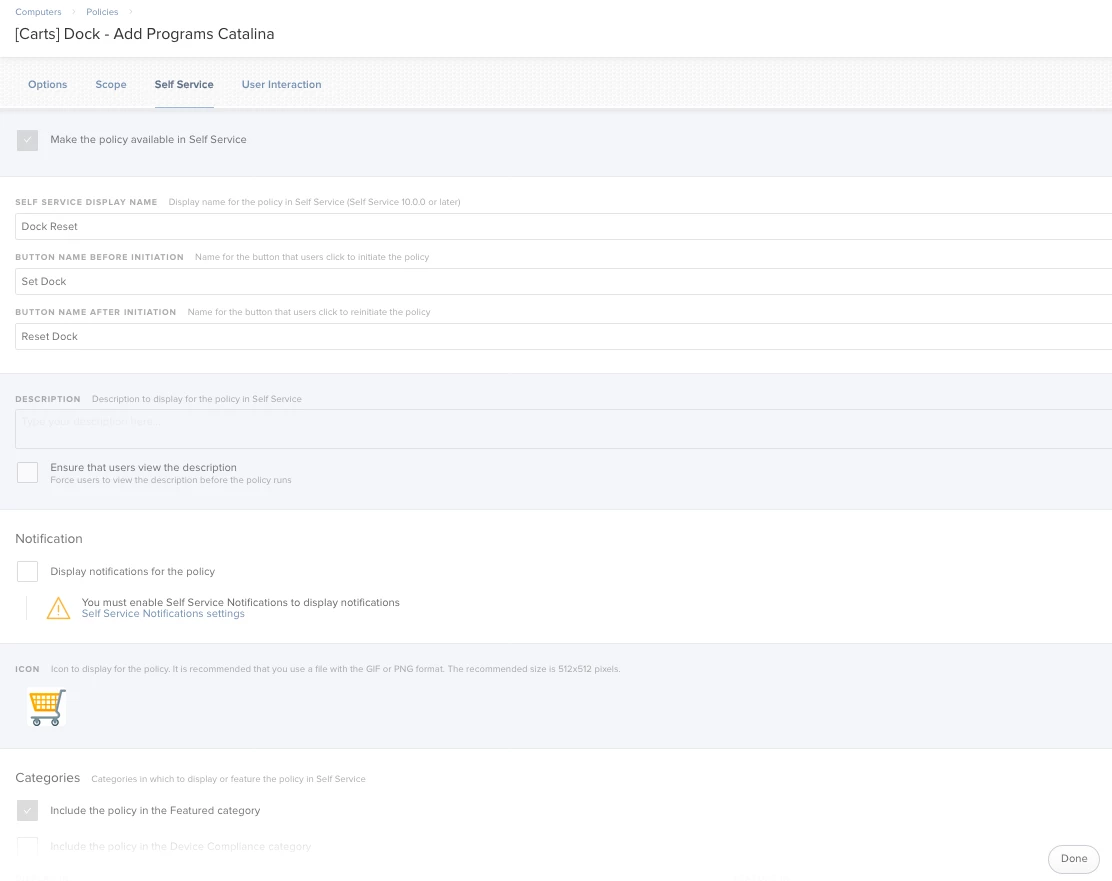

I use a policy. See attached. Make sure your policy has every app on your dock, removed or added.
Special Note: The magic here is the killall command in Files and Processes.
I also keep the policy in Self Service so it can be reset without restarting the entire machine. YMMV.
Also, here is my dock items from Settings. This "should" be up to date.

When you say....... Make sure your policy has every app on your dock, removed or added.
Every App on your dock, BEFORE the policy is applied, or Every App in the policy?
In other words, when you take a computer out of the box, there will be some apps on the dock. Are you referring to these app in your dock? Sorry for the confusion, just trying to figure out why for you its all file://Macint...... and for me its a mix of that plus file://Applications........
  • November 25, 2019
Every app on the dock natively, or that is going to be added to the dock, must be accounted for in Settings -> Computer Management -> Dock Items.

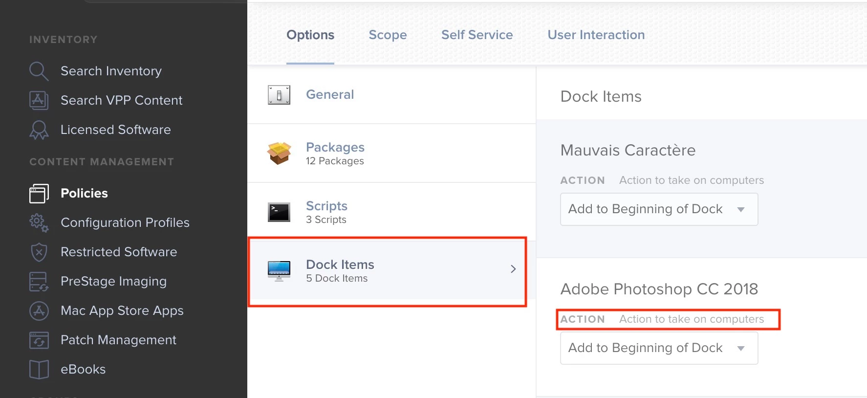

@larry_barrett Thank you for your reply.
However from High Sierra, we use Policies that our IT support team triggers via the self service in order to install application profiles with shortcut in the Dock.
Policies are on Ongoing.

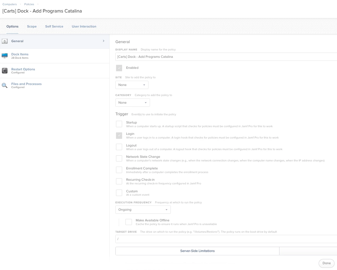

I don't know what to say anymore. My policies are posted above. It works on Catalina.
Here is a screenshot of my dock, every computer in my lab looks exactly the same.
This machine was on Mojave an hour ago, now its Catalina.

The only difference is that I don't put with the trigger 'Login'.
Our Support team executes the Policy only once on the workstation and the dock keeps the applications even by opening new user accounts on the workstation without having to trigger the Policy at each login. In any case it works like that with High Sierra and Mojave.
