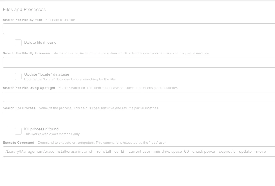

Here is the script command I am using..
/Library/Management/erase-install/erase-install.sh --reinstall --os=13 --update --overwrite --current-user --min-drive-space=60 --check-power --depnotify --cleanup-after-use

So I re-read the documentation on erase-install and i thought maybe the --update flag was interferring so I changed the command line to this
Running command /Library/Management/erase-install/erase-install.sh --reinstall --os=13 --overwrite --current-user --min-drive-space=60 --check-power --depnotify

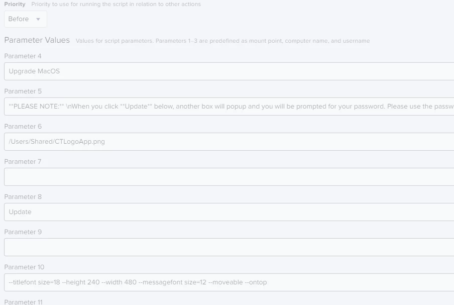

dialog="/usr/local/bin/dialog"
if [[ -n ${4} ]]; then titleoption="--title"; title="${4}"; fi
if [[ -n ${5} ]]; then messageoption="--message"; message="${5}"; fi
if [[ -n ${6} ]]; then iconoption="--icon"; icon="${6}"; fi
if [[ -n ${7} ]]; then overlayoption="--overlayicon"; overlayicon="${7}"; fi
if [[ -n ${8} ]]; then button1option="--button1text"; button1text="${8}"; fi
if [[ -n ${9} ]]; then button2option="--button2text"; button2text="${9}"; fi
extraflags=${10}
action=${11}
