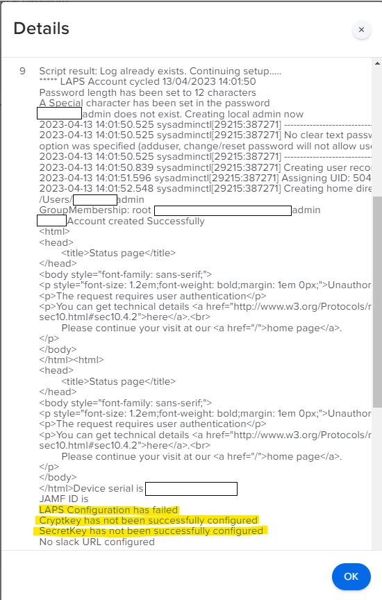

Hi @perryd84, first of all, nice work on putting this LAPS solution together. I have been struggling to find a more secured LAPS solution for MacOS in our company that can replace an old script from 7 years ago which now has multiple problems.
I have gone through your setup, and I have got most of it working except for the most important part; the LAPS password can't be retrieved, neither can't I see the encrypted password information in the Extension Attribute in Jamf for my test device.
After the LAPS account is created on the device, and the LAPS package in installed successfully, I get the below error:
LAPS Configuration has failed
Cryptkey has not been successfully configured
SecretKey has not been successfully configured
Any ideas as to what could be causing this issue? I have followed the steps to encrypt the API account password and that's the value I've used in the policy I created, which I though was all I needed to do.
Any help would be much appreciated 😇.
Thanks!!
perryd84
  • April 13, 2023
Hi @ClaudiaP
So this looks like an authentication issue. I have found that sometimes if a new API account is created the password needs to be reset a couple of times before it can be used in a script. No idea why but it seems to fix this issue.
Another issue could be account permissions. Have a look at this link it details the lowest amount of permission for the API account to work.
Keep me posted how you get on.
