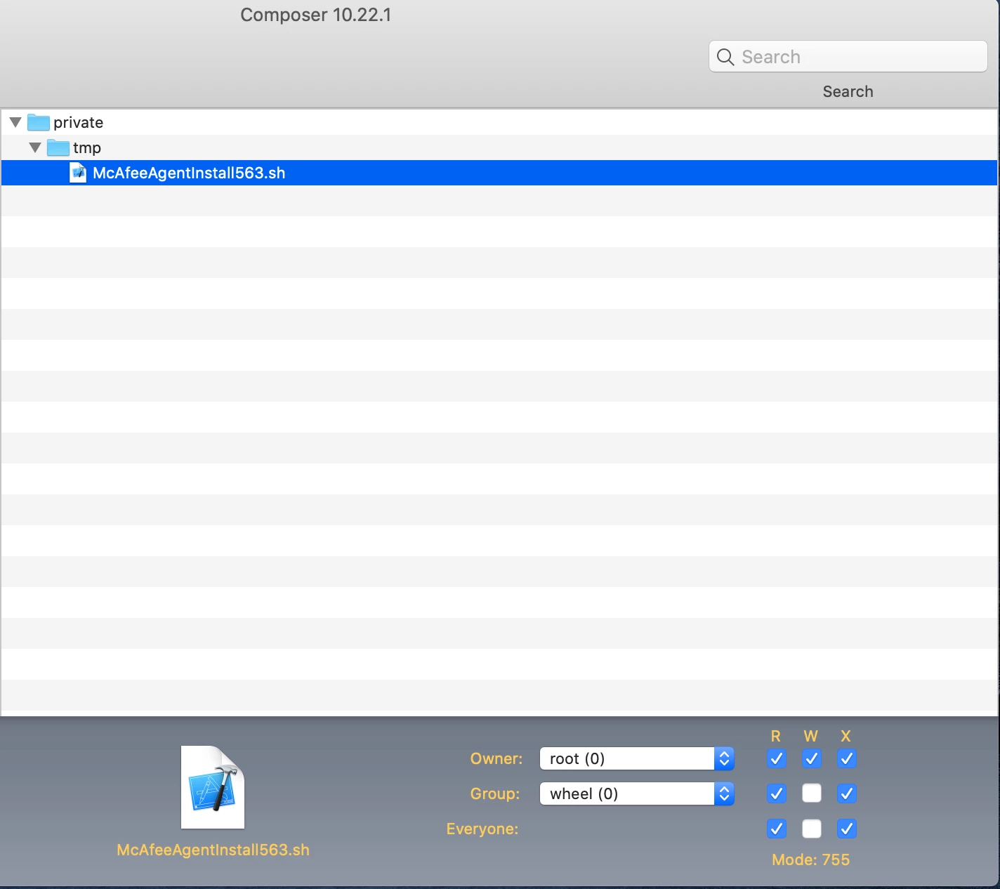

I have had success deploying McAfee Agent thru Jamf for a long time now using the same method since 5.6.2-5.6.5 and on Mojave or Catalina. Here is how I do it:
  1. Take the install.sh file for the version I am packaging and rename it to McAfeeAgentInstall563.sh then place it in this location on my packaging Mac: /private/tmp/
  2. Drag that file into Composer to create a new pkg. Make sure owner is set correctly on the tmp folder and the file itself root:wheel. tmp folder 777 and McAfeeAgentInstall563.sh 755

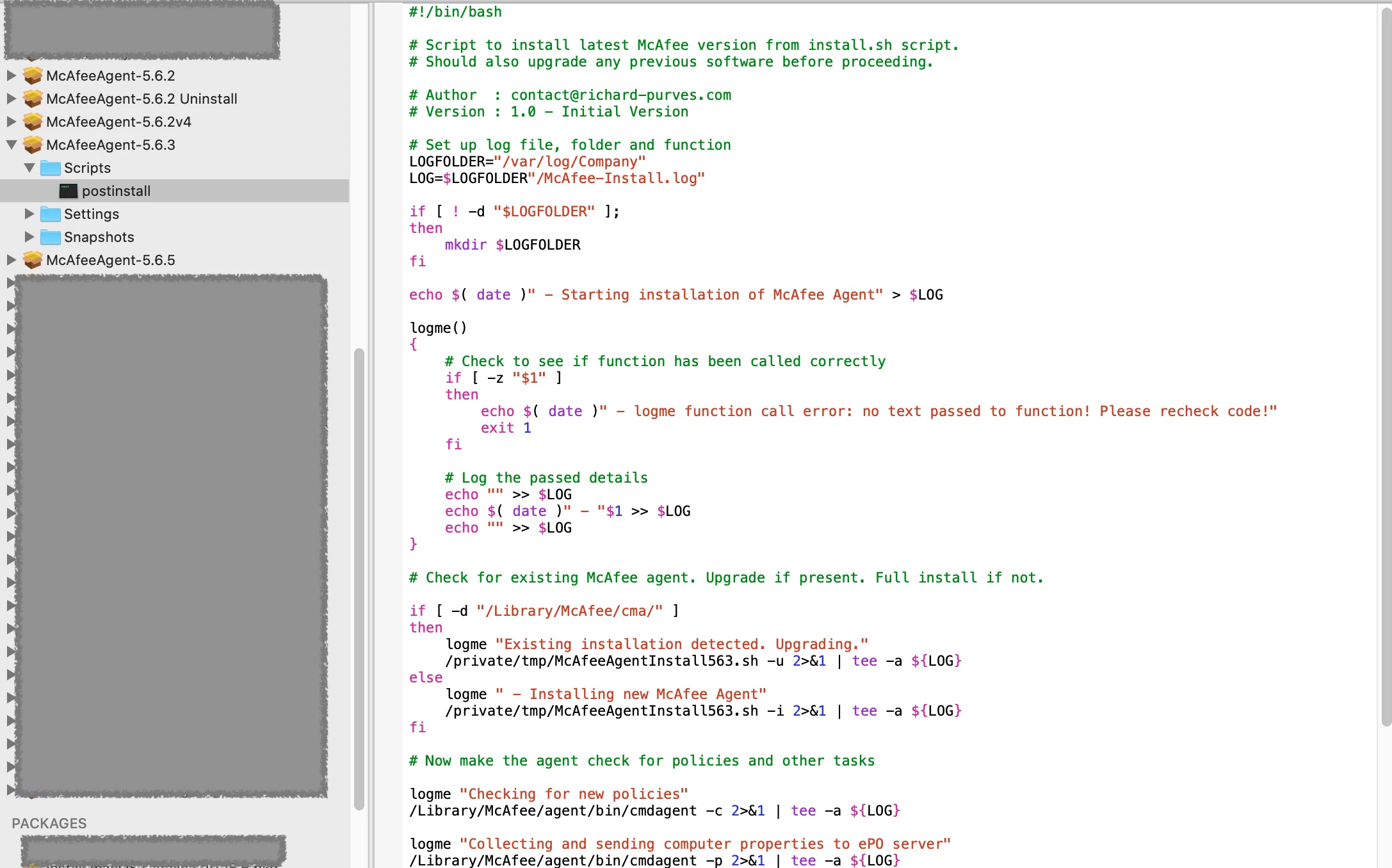

  3. Click on the Scripts folder of the pkg and add Shell script>postinstall
  4. I then use an old script created by @franton with some path changes on lines 40 and 43, to point to where I put the McAfeeAgentInstall563.sh script. You can find that script here on his GITHUB
    Nice thing about the script is if it detects mcafee agent is installed already it will do an upgrade and if not does an install.
    Some of the additional commands at the end of the script often fail for me but I assume its because its running too soon after being installed and before the agent is even communicating with ePO. But I always end up with a functioning agent.
  5. Have package created/signed in Composer then upload to Jamf and deploy with a policy.
Hope this helps some of you.

@chase.garcia THANK YOU that worked! I should have just followed your post to a T to begin with.

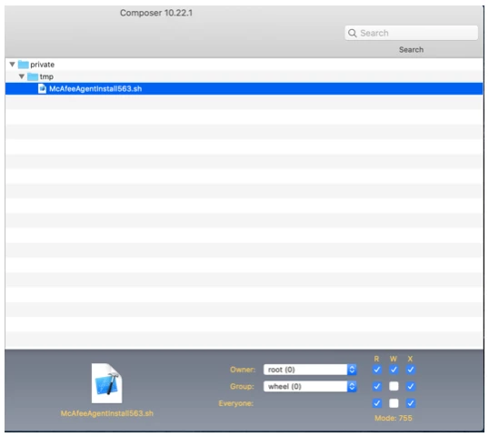

Here's how I resolved this issue. Took the MAgent script, built it into a dmg via Composer. Location I placed it in was /tmp/, then I used a post install script to copy it to the /tmp/ location on the local HD. After that I ran the install.sh -I command (works via processes or script). This worked without getting any Read - only errors. Hope this helps someone.
  • January 19, 2021
@kylejordan09 I'd like to try your suggestion. What postinstall script do you use to copy the MAgent script onto the local HD's tmp folder? I'm still new to the Mac world, but I take it that the local HD tmp folder is different than the universal tmp folder (/private/tmp/).
MikaelDez
  • January 19, 2021
@cdiaz2 I use Composer, and I just put the install.sh file into /private/tmp. Then I add a postinstall script thats essentially the script from Github a few comments back, only I alter the script to reflect the /private/tmp/install.sh path. I have had zero issues with deploying the Agent in this manner since I was given that advice!

@MichaelMcG
I throw the install.sh file into /private/tmp, drag it into Composer and update its permissions (tmp folder is 777, file is 755):
Then I add a post install script in Composer (All I did was take out the end piece where it checked for updates and I updated the path in the script to reflect /private/tmp/install.sh):
# Script to install latest McAfee version from install.sh script.
# Should also upgrade any previous software before proceeding.
# Author  : contact@richard-purves.com
# Version : 1.0 - Initial Version
# Set up log file, folder and function
LOGFOLDER="/var/log/organisation"
LOG=$LOGFOLDER"/McAfee-Install.log"
if [ ! -d "$LOGFOLDER" ];
then
    mkdir $LOGFOLDER
echo $( date )" - Starting installation of McAfee Agent" > $LOG
logme()
# Check to see if function has been called correctly
if [ -z "$1" ]
then
echo $( date )" - logme function call error: no text passed to function! Please recheck code!"
exit 1
# Log the passed details
echo "" >> $LOG
echo $( date )" - "$1 >> $LOG
echo "" >> $LOG
# Check for existing McAfee agent. Upgrade if present. Full install if not.
if [ -d "/Library/McAfee/cma/" ]
then
    logme "Existing installation detected. Upgrading."
    /private/tmp/install.sh -u 2>&1 | tee -a ${LOG}
else
    logme " - Installing new McAfee Agent"
    /private/tmp/install.sh -i 2>&1 | tee -a ${LOG}
# All done!
logme "Installation script completed"
