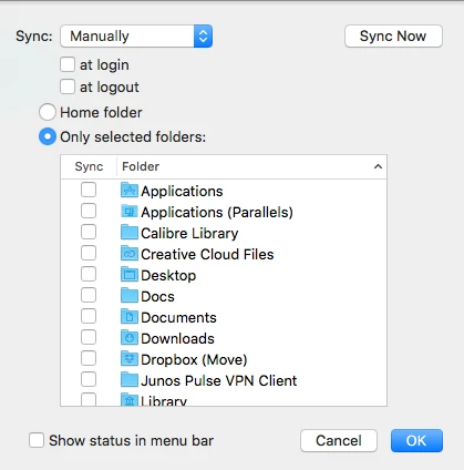

Posted on 04-06-2016 01:12 PM
@Matt.Ellis What are the sync options set in System Preferences-->Users & Groups-->(current.user)-->Password-->Mobile Account:Settings? Ours' is set by Group Policy via Centrify as is whether network home folders would automount and that should be disabled.
As a test, check to see what effect turning off WiFi has on the login times when offsite.
Posted on 04-06-2016 01:52 PM
So i tested with the mobile account settings set to "Manual" and to not sync any folder at login / log off.
Before i did that i was seeing the following
On Ethernet login 43 Seconds
Off ethernet login: 1min 42 Seconds
After change
On Ethernet 35 seconds
Off Ethernet 1min 39seconds
Funny thing is after i went back in to the settings the applications and parallels applications re-checked themselves.

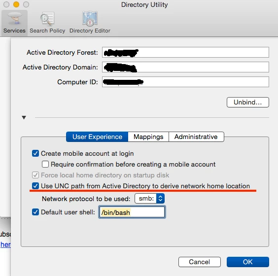

If the users never use their network home folder, have you looked at unchecking this option?
I've never disabled that option myself because every Mobile User environment I've worked in uses their network home folder.
Posted on 04-07-2016 06:14 AM
@AVmcclint In our environment we always uncheck that box. Never used it and it doesn't really matter, we instruct our users to "Connect to Server" if they need the home directory. From what I have seen most Mac users know how to do this and don't complain about not having their home directory mapped.
We have a similar setup as well, FileVault 2 enabled with Mobile Account and boot time is around 20 - 30 seconds with out that option checked.
