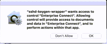

I have a couple extension attributes for Enterprise Connect that utilize the EC command line utility (/Applications/Enterprise Connect.app/Contents/SharedSupport/eccl).
During Mojave testing, I have noticed machines get a privacy prompt when I run a recon remotely via SSH on a machine.
The first instinct is to create a privacy prefs policy for sshd that gives it access, but that seems like it could open up a security issue.
Has anyone run into something similar or have any ideas?

Since it specifically references Enterprise Connect and only happens on recon, my first suspicion is a script in an Extension Attribute is doing something to manipulate Enterprise Connect (maybe an AppleScript tell block or something?). If you can't change the EA script to work around that, adding a PPPC profile which only allows sshd-keygen-wrapper to send events to Enterprise Connect may be sufficient?

EAs ran on normal check-in would be asking for access but likely being denied since no prompt would be given. The prompts are pretty accurate representations of what would be shown in the tcc logs for what it sees as the parent process:
##to see current requests
/usr/bin/log stream --debug --predicate 'subsystem == "com.apple.TCC" AND eventMessage BEGINSWITH "AttributionChain"'
##or to see previous requests (doesn't show full history, just recent history - still investigating what resets this)
/usr/bin/log show --predicate 'subsystem == "com.apple.TCC"' | grep Prompting
But I would guess that you would need to whitelist the Jamf binary (for normal check-in policies) and the jamf agent (for self service recons) using the AppleEvents service to communicate with Enterprise Connect as the receiver (I don't have that so I can't provide the identifier or code requirement of EC).
Now this specific allowance of Jamf > Enterprise Connect would not cover Jamf polices ran via terminal or while SSH'd in since that would be shown as the parent process per apple (terminal>jamf>enterprise connect or ssh>jamf>enterprise connect). You could whitelist terminal and/or ssh but as you had noted that would be negating the point of these new security settings.

@mike.paul Users do actually get prompted in this case (running recon via SSH and having an extension attribute that calls a cl utility like eccl)
This obviously limits the functionality of EA's in that you cannot use these app cl utilities to populate said EA's.
Either that, or just remind people to never run recons over SSH :).
Just remembered that it bears mentioning that this cl utility runs in the user context. Here is the EA in question:
user=$(stat -f %Su "/dev/console")
status=`su - "${user}" -c '/Applications/Enterprise Connect.app/Contents/SharedSupport/eccl -p signedInStatus'`
    echo "<result>$status</result>"
Thanks again for your help.
