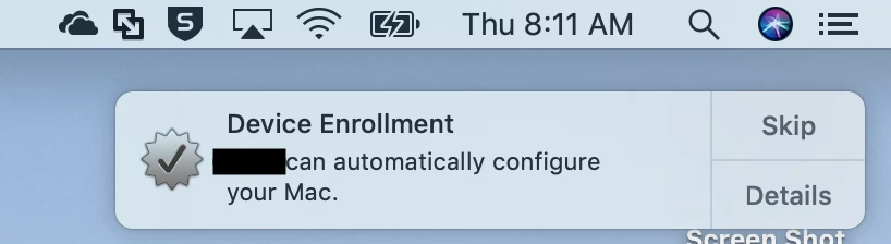

I am unfamiliar with "DEP notification". What is that?
  • January 11, 2019
@matthew.johnson I know this is late, but the DEP notification is this:
