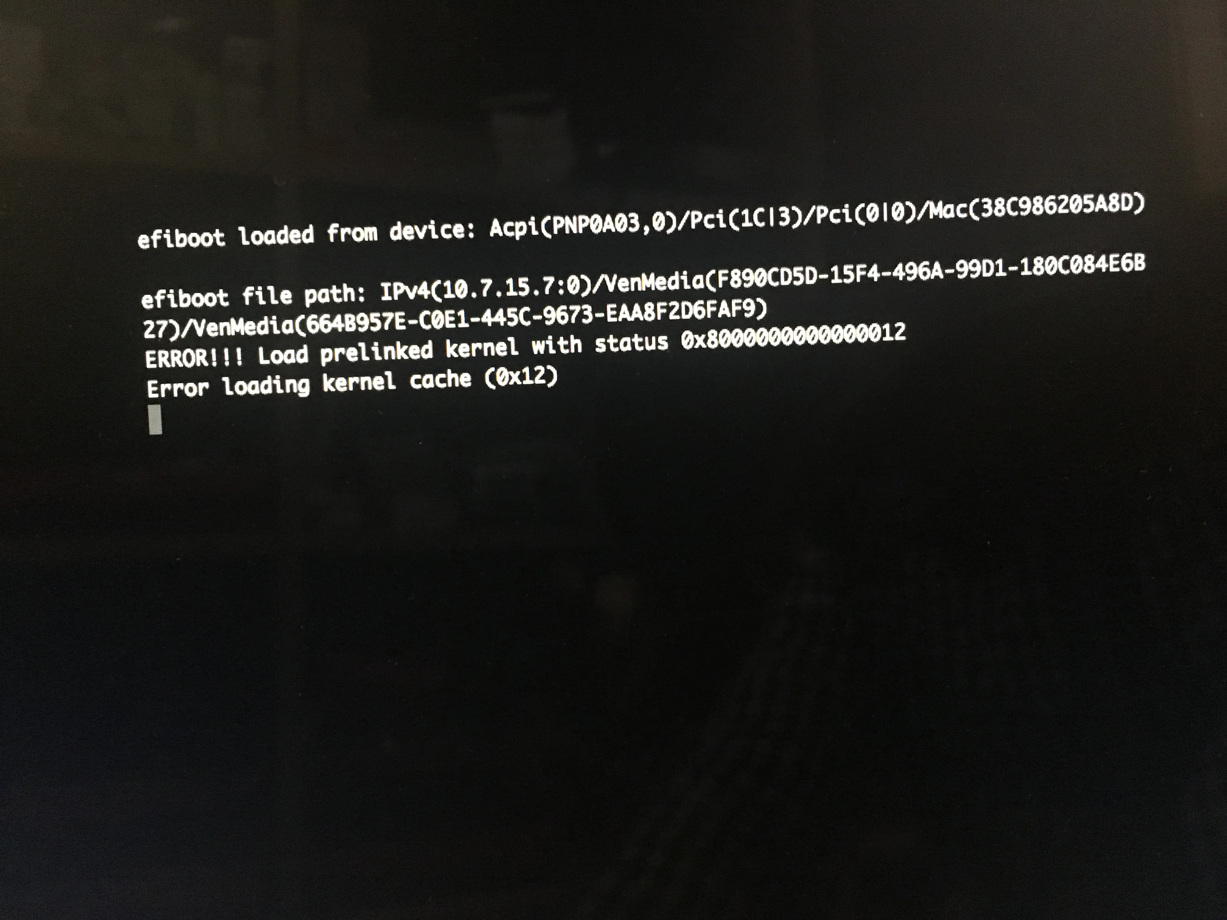

We have recently started experincing some netboot issues. The issue has been discussed but can't seem to find an appropriate solution for this.
  1. We can't netboot from any 2015 devices it comes up with circle with diagonal line. 2.Older MacBooks work fine such as 2013 and 2011 Macs that's what we have tried so far.
We use AutoCasperNBI and Autodmg to build nbi.
Casper Imaging version: 9.97
OS: 10.12.3(even tried 10.11.6)
Built on Early 2015 MAcBook Air and also tried Late 2015 iMac.
Logged a ticket with JAMF support and we agreed that the issue is hardware related but can't find a solution.

We had a similar issue here, but it only affected 3 out of 52 "Late 2015" iMacs. We could install from USB, but when it came to netboot it just would not do it! We had the mainboard replaced in all 3, and this fixed the problem.
There are 2 things i would do:
  1. Use the System Imaging Utility to create a MacOS Sierra NetInstall Set (You need to be running MacOS Server, not NetSUS to do this). This will help determine if it is the AutoCasperNBI set, or all netboot sets.
  2. Send 1 machine off to your service provider, and ask them to change the mainboard. If this fixes it, they aren't going to be happy when you ask them to change ALL of your mainboards!

@Chirag_Barot the prohibitory sign means the system can't find an OS or can't load the OS. This is do to a how you are building your netboot OS. This is more of a hardware is not liking the build of the OS you are trying to load thats on your netboot image.

I actually ran into this yesterday with my earlier macbooks, what I refer to is "white macbooks". I was also looking for a solution but I think I somewhat have it figured out. Not a solution, but the reason as to why. I have Deploy Studio that I am actually using. I create netboots from the Deploy Assistant. I can boot the newer (silver) macs into it but not the white ones. HOWEVER, I WAS able to boot the white macs into it BEFORE I upgraded my mac mini that houses my server. Once I upgraded the macmini, it prompted me to updated my Server app and all the related components, in this case the deploy studio. I did all that but then could not net boot. I had to create a new netboot image because the system was upgraded. What do you know, the netboot automatically created an image named 10123 (10.12.3 Sierra). Now I can not boot to it with the same circle as you have. My only guess is that the system and server that I am booting to are much newer than what I currently have on these white macs therefore wont' boot to it. Because it was just fine before that.
Okay so found that the new devices won't boot into the netboot if they are not on the same vlan as the netboot server. As soon as i changed the vlan on all switchports i could reimage the devices.
