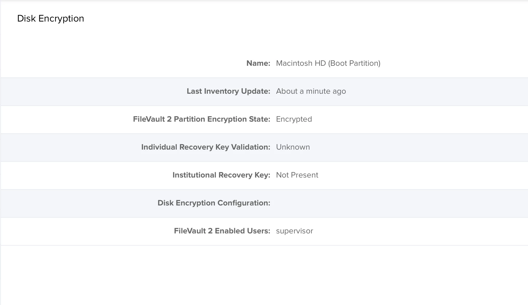

Hi all,
Just had a batch of new Macs arrive Today and noticed that after enrolment they all report to the JSS that FileVault 2 Partition State is "Encrypted". This is despite FileVault not being enabled and no password prompt prior to booting into the OS. This has happened on all the new Macs that arrived. I can manually enable FileVault, this works fine.
I'm assuming this is something to do with the new Secure Boot?
As the new Macs are not showing as encrypted the FileVault policies we have in place are not being applied, as they don't fall into the smart group.
Has anyone else ran into this issue?
5 replies
  • September 5, 2018
The T2 chip is encrypted automatically causing the false positive. Jamf is aware of the issue. if you use any sort of Extension Attribute use this instead:
filevault=`fdesetup status`
echo "<result>$filevault</result>"
