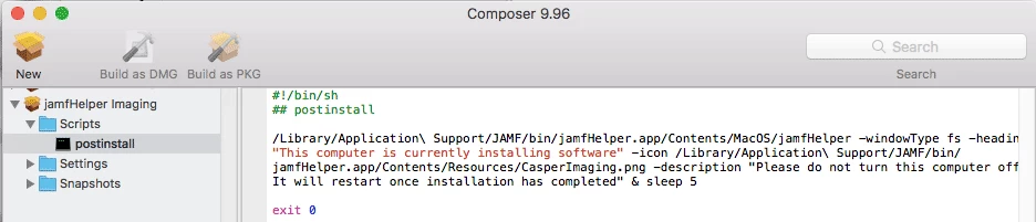

This is the exact same issue we have had for many versions! We had an open ticket with JAMF but never got resolved. Some Macs would display the jamfHelper, some wouldn't.
The way we get around this is to execute the jamfHelper at the start of the imaging process (whether the original jamfHelper executes or not!) via a postinstall script in a package created in Composer.
Now every Mac gets the splash screen (original or custom)
