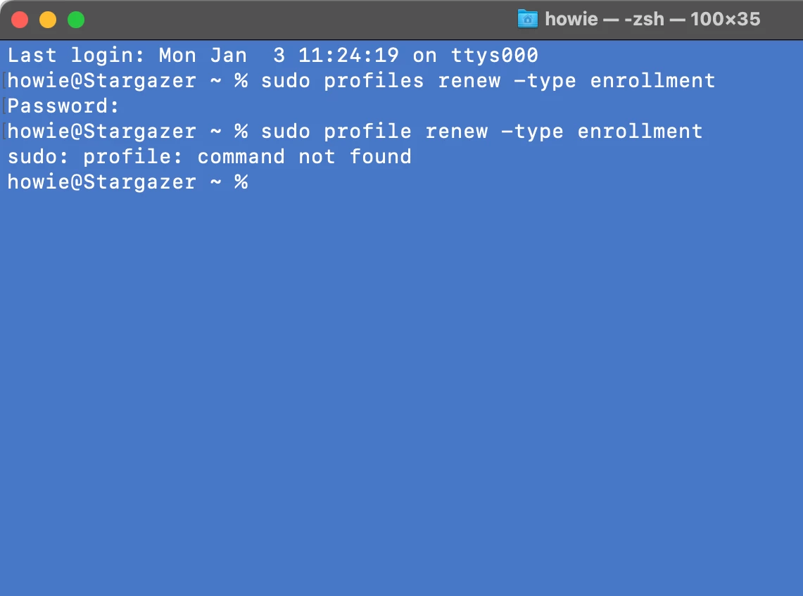

Also tried the following commands in Terminal during restart  :
a. profiles renew -type enrollment
It says profile : command not found
For below 2 commands , it asks for password for user_mbsetpuser
b. sudo profiles renew -type enrollment
c. sudo profiles -N
Have you made sure that the serial number of this system is scoped in the prestage enrollment? The serial number may be there, but it needs to be checked. Also, what happens if you move on and just setup an account on the Mac, and then use "sudo profiles renew -type enrollment" in Terminal?
Are you typing this with an "s" at the end of profiles? I tried recreating the issue. When I type the command "sudo profiles renew -type enrollment" I am prompted for my password and then nothing happens since I'm using a Mac that is already enrolled and it is not in ABM. When I type it with the "s" missing from profiles I get the same result you did.
Its profiles (not profile).
Device is enrolled in Jamf pro and ABM , also tested with profile but it is asking for password mbsetupuser$
What do you mean by "tested with profile". What are you doing that triggers the request for a password? If a Mac is in Apple Business Manager, and you have a working  prestage enrollment in place, and the Mac is scoped to this prestage enrollment, then it should auto-enroll when it is first booted up after being erased and reinstalled. I am not understanding what your workflow is. To help you, we need to know what steps you are following.
