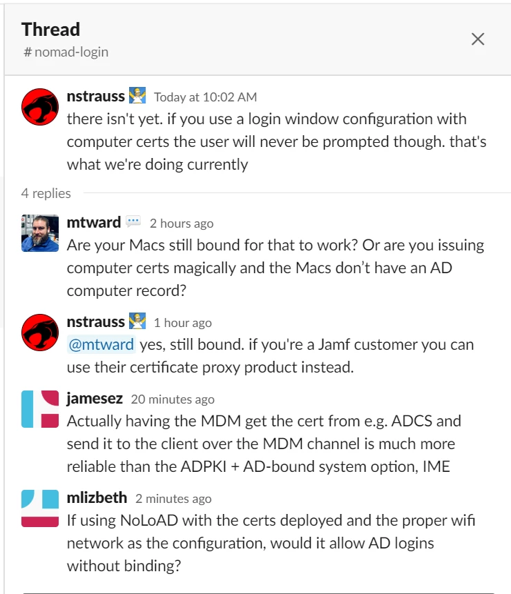

I asked this question on the MacAdmins slack because I have been wondering this too.
There is no GUI for selecting your wifi network at the login window with NoLoAD like there is with apple's login.
However, they said if you deploy a configuration profile that sets the network at login and includes the certificate it should still log them in.
I do not know if this works without binding, I also suggest you test it locally before considering a deployment.
