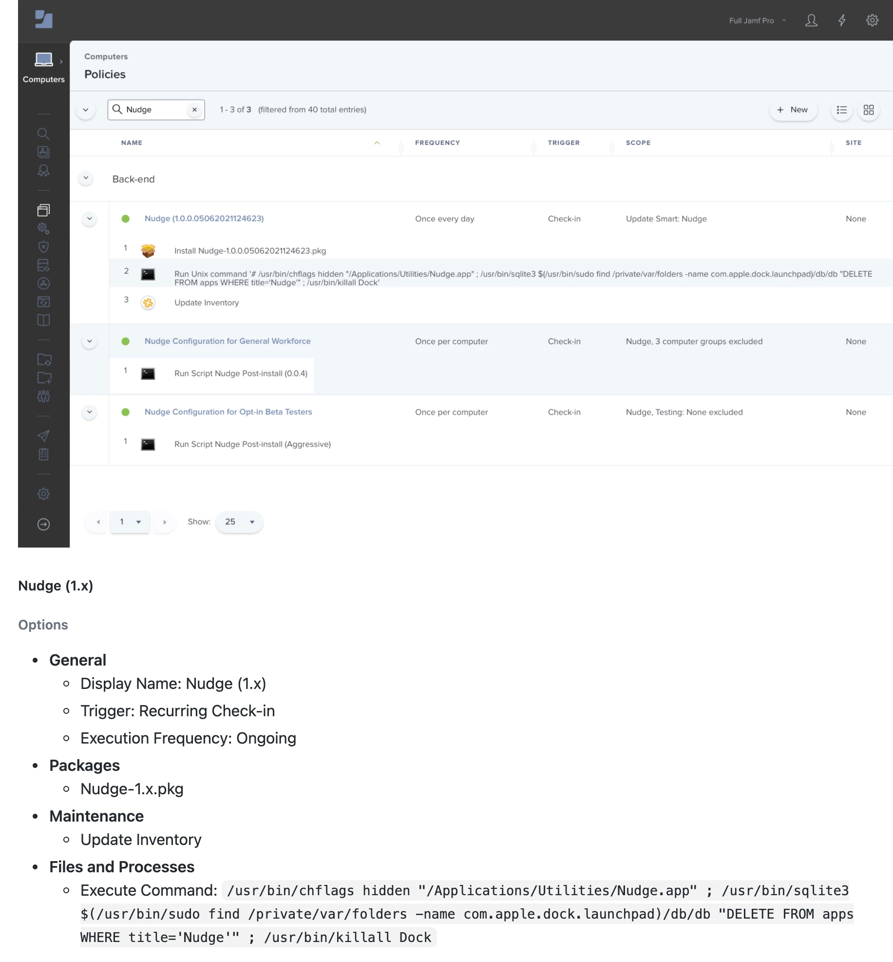

Can anyone confirm what setting to use on the frequency?  Pic shows Once per day but in the typed section, it is showing ongoing.  That would be a ton of backend processes.
Our Nudge deployment is set up with Nudge.pkg and LaunchAgent.pkg pushed once per computer along with scoping the Nudge JSON configuration profile. Didn't set it up via this Jamf Guide Scripting method. Just started to test and deploy this for the Big Sur machines. It was working perfectly for the testing and we pushed it out to more users and now we are unable to click on the "Update Device" button but able to hit the return key to get the software update pane to open. Posted to macadmins slack to see if others have seen this.
I would suggest, Keep it once per day as Keeping frequency ongoing for every 15 mints along with update inventory can increase load on your jamf database
