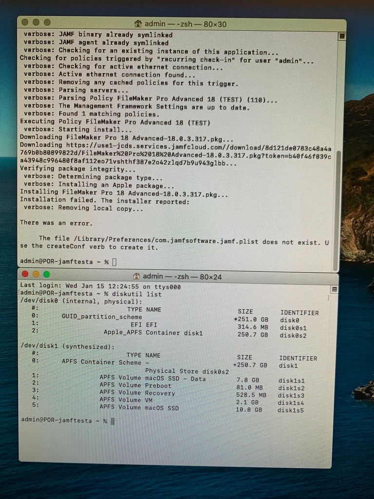

We've experienced a serious issue where nearly 90 out of about 100 Mac computers have had enough data erased from their volumes, including any attached or mounted network volumes, that they are non-functional. It wasn't a complete volume wipe but a random (seemingly) brute force file deletion all across the local volume(s). macOS version or format did not seem to matter. Additionally, the time zone gets set to UTC instead of what it should be and passwords stop working (we're assuming this is because of the file deletions).
This does seem to tie in with a specific policy running, but its a policy that installs an app via a pkg. Its an ARD modified installer pkg for FileMaker Pro 18 Advanced using the—flawed—instructions from Claris/FileMaker.
We have since enlisted the help of a Cybersecurity team to help us investigate but we are wondering if anyone else has experienced something similar? We don't yet know if we screwed something up, if our Jamf Pro cloud server messed up, if Jamf messed up their backend, or if this was something malicious.
In the attached screenshot note that it isn't the FileMaker policy that is failing its because most the data on the local drive has been deleted, including Jamf.

It's probably all frozen now but how was the policy configured? Run pkg, submit inventory, that it? What instructions did you follow to create the FileMaker Pro Advanced 18 pkg?
Is it all Catalina-specific like in the screenshots? Any difference when installing the custom package by double-clicking in the macOS GUI?
That "removing local copy" line is interesting. I am wondering if because its Catalina, there is something not quite right with how you are setting up the image originally possibly? Write access is blocked for Catalina library and system files, but perhaps the pkg installers are breaking one of the symlinks somehow which then looks like things are missing?
Can you open the pkg and look at any scripts that run during the install?

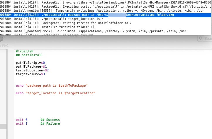

I'm with @gshackney and @mm2270, judging by the variable names, whoever wrote the script flipped PACKAGE_PATH and TARGET_LOCATION (never even calling PACKAGE_PATH), and so when they did the "clean up" they did everything at / as root recursively, and if it wasn't SIP protected it was napalmed. Screen cap of a test I did with a simple package to spit out that if you used Composer to make the package, $2 is target path which seems to default to "/", which would include connected volumes. I think this might be an RGE more than a targeted attack.
