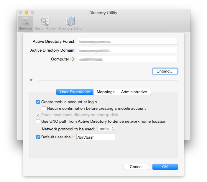

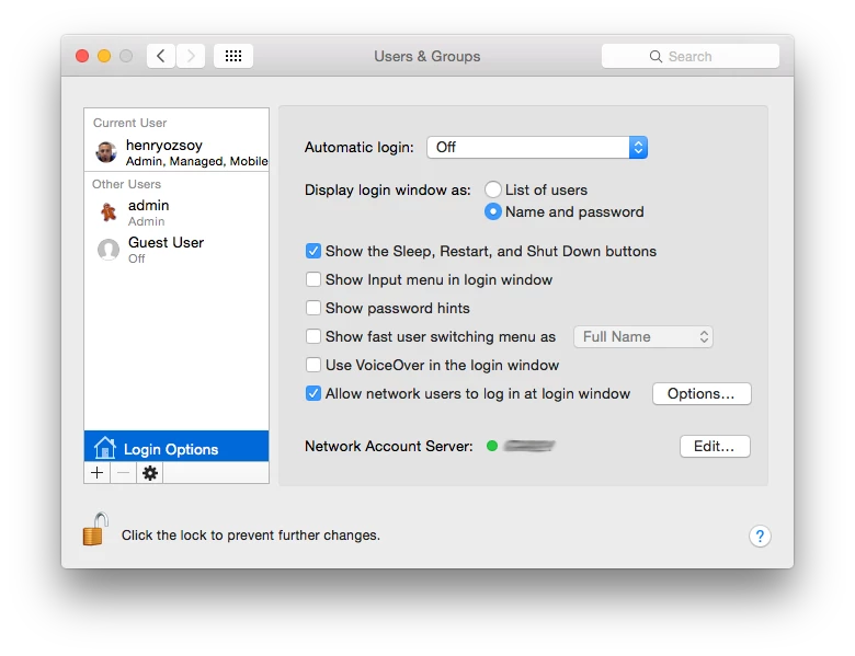

if you use their ad credentials to logon to the machine and force to machine to change the account to a mobile local account then your issue will be resolved.
