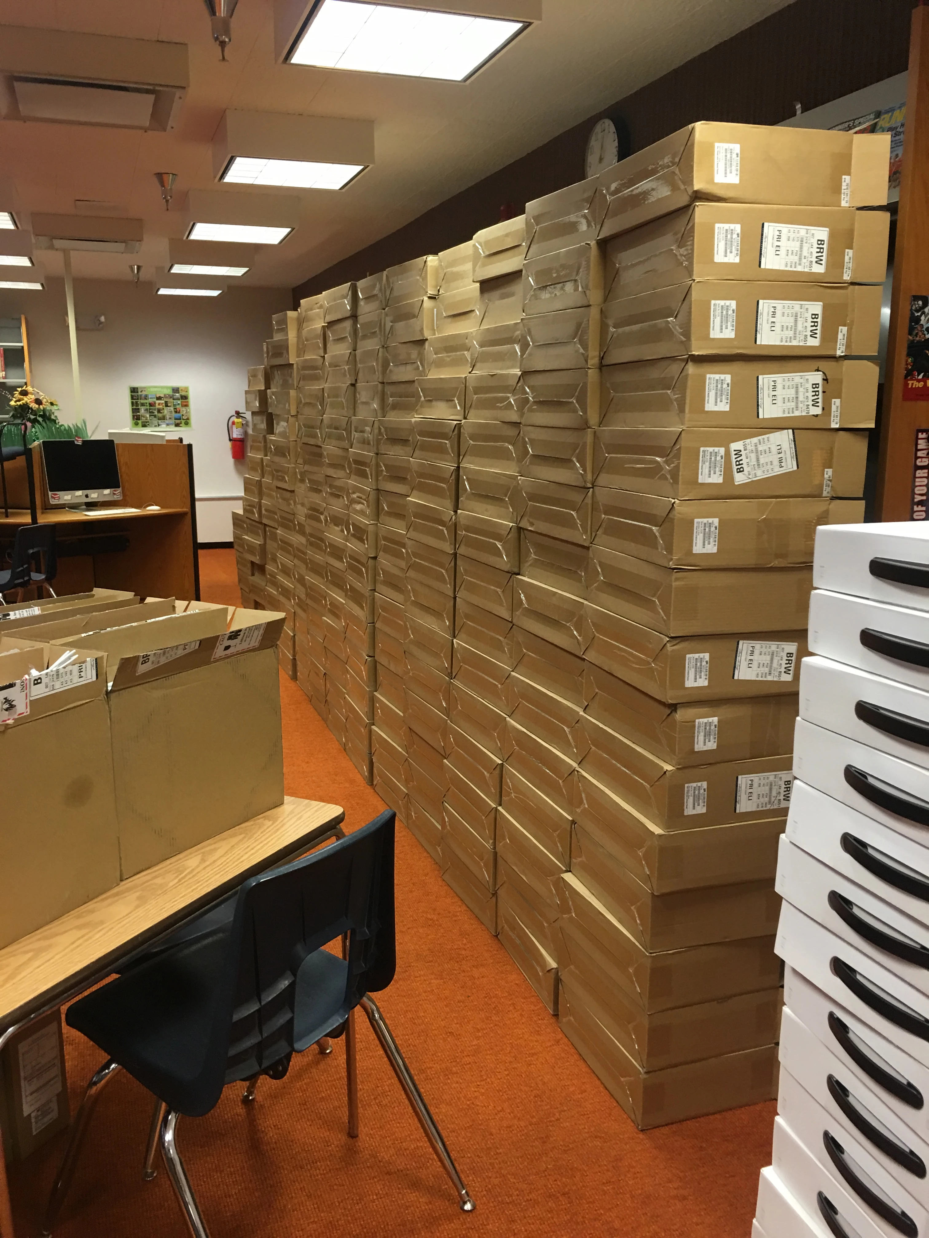

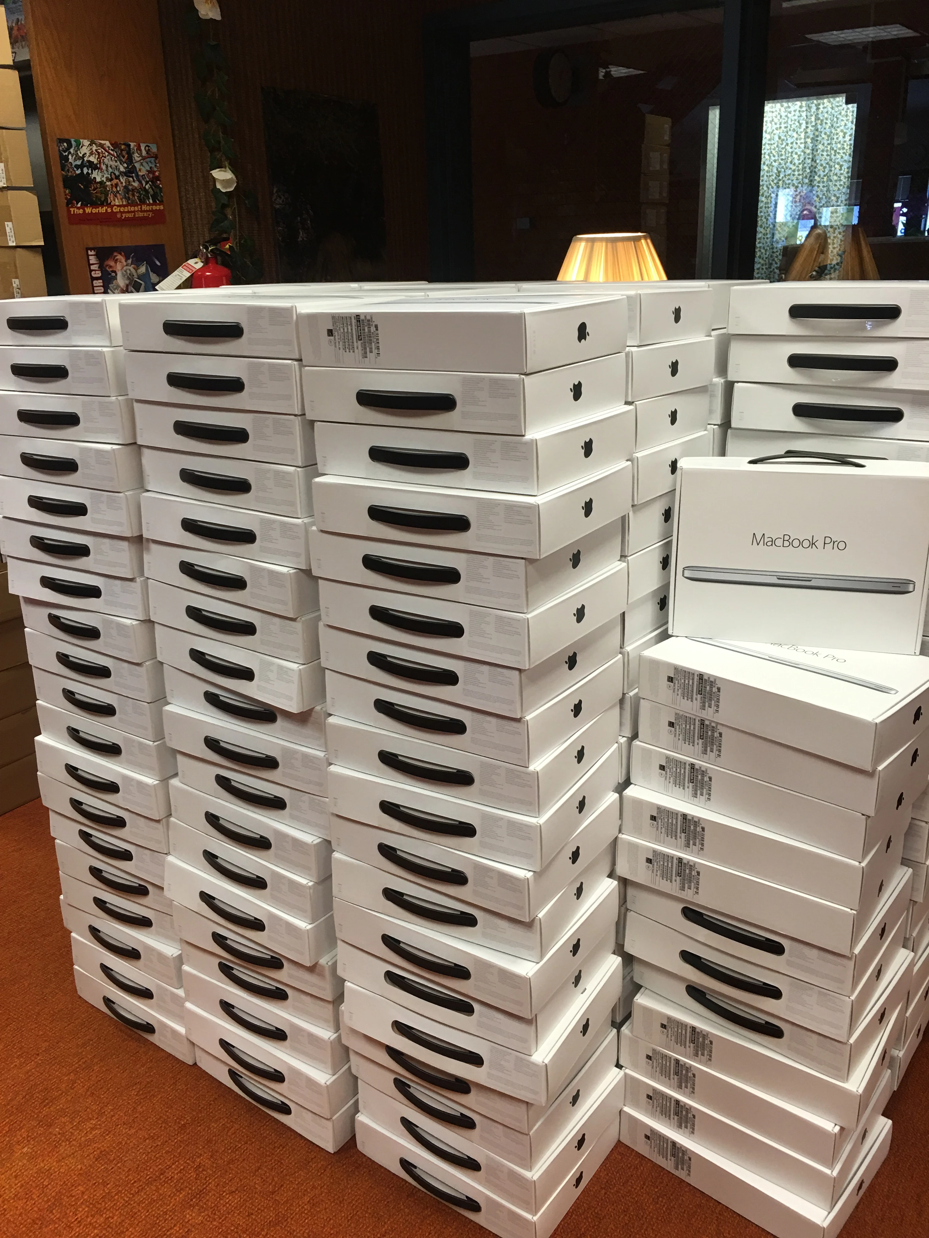

@Sandy The above fix on the link you provided didnt work for us. We have 400 brand new MBP and the issue is happening to all of them. We have to reboot once after the error, then the imaging will start successfully. Can anyone be so kind to share a ready made script to nuke the HD before the Casper Imaging takes place? and please teach me how to add it to AutoCasperNBI. We are on 9.92. Imaging 10.11.5, AutoCasperNBI is on latest release and using 10.11.5 as well. PreStage imaging is useless because of this stupid error!
I also just want to share what Apple Changed this year. Apparently, they stopped shipping bulk orders of Laptops in 5 Pack boxes, instead they are boxed individually! How frustrating just unboxing them! Such a waste! Not very environmentally friendly at all!
