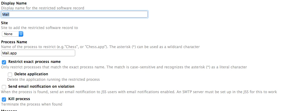

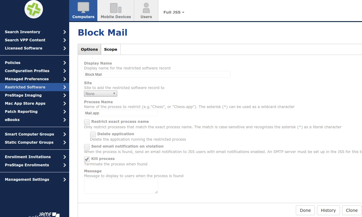

Is Mail actually starting up? I have Apple Mail set as restricted software on our student computers. I originally had a dialogue box pop up whenever the process was killed informing the students to use the browser to access their emails, but due to the process being found 2-3 times during boot I now just have the process killed. All of our student computers are on 10.11 currently. I haven't found any issues just killing the app this way. Am I missing something about your question? I'll attach a screenshot of my configuration if that helps.

Mail and iBooks are actually trying to start up. I have a restriction message setup to notify the user that these apps are not available for use. I have attached the screen shot. The only thing that I see different in mine is that I have the "Restrict exact process name" checked. I will uncheck that and see if that does the trick. I have also attached a screen shot of that restricted process.

Hey all,
After doing some digging, we've found this to be the result of an incorrect workflow.
If we have the box for Restrict exact process name checked, we should not be adding a .app to the end of the process name, as the process name itself does not have .app in it.
In the case in this thread, we would want to either uncheck that box, or edit the process name field so it reads Mail.
The PI mentioned (PI-003002) has been closed out as Not An Issue.
Thanks!
