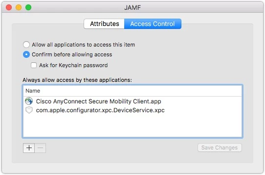

If you use cert based auth with anyconnect and your users constantly get prompted to enter in an admin username and password to (usually) access the system keychain, its because anyconnect is searching all keychains for certs and it hits a cert in there and wants to read it to see if it is valid and the system keychain requires an admin authentication to access it (usually the JAMF Identity cert that gets installed during enrollment). To get it to stop doing this you can:
  1. go into Keychain Access select your system keychain
  2. filter the category by My Certificates
  3. select the private key in the certificate pair
  4. right click it and do a get info on it
  5. in the Access Control tab, manually add the Cisco AnyConnect app to the always allow access box.
It will prompt you for admin credentials a few times but you shouldn't get bugged again.
  • October 5, 2016
@chriscollins Thanks for your reply. I'm aware I can do this, but manually doing that across ~150 machines and growing is not really a task I'm able to undertake ... not to mention running it again when the certificate expires and the machine pulls a new one.
