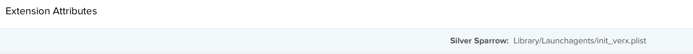

I'm trying to figure out how to craft a smart group using the results of this EA. I manually created a file called "init_verx.plist" and placed it at ~/Library/LaunchAgents. The EA detects it. What I was looking for was an integer. That's what the EA seems to use. This is what I see in my machine inventory. I assume if the other files were present, I would see those too.

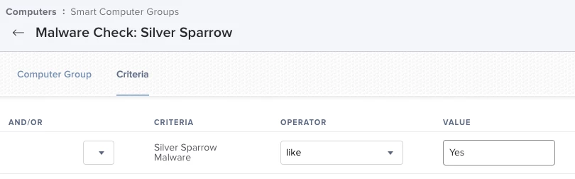

Here's the EA I'm using, partially adapted from the @ehemmete EA that @mark.mahabir posted above. My results add a "Yes: " to the list of offending files so you can configure a Smart Group like in the image I've posted below.

The EA from @ncworster worked great. It picked up all of the test files that I created. I setup a smart group that sends an email when a Mac becomes a member of the group.
