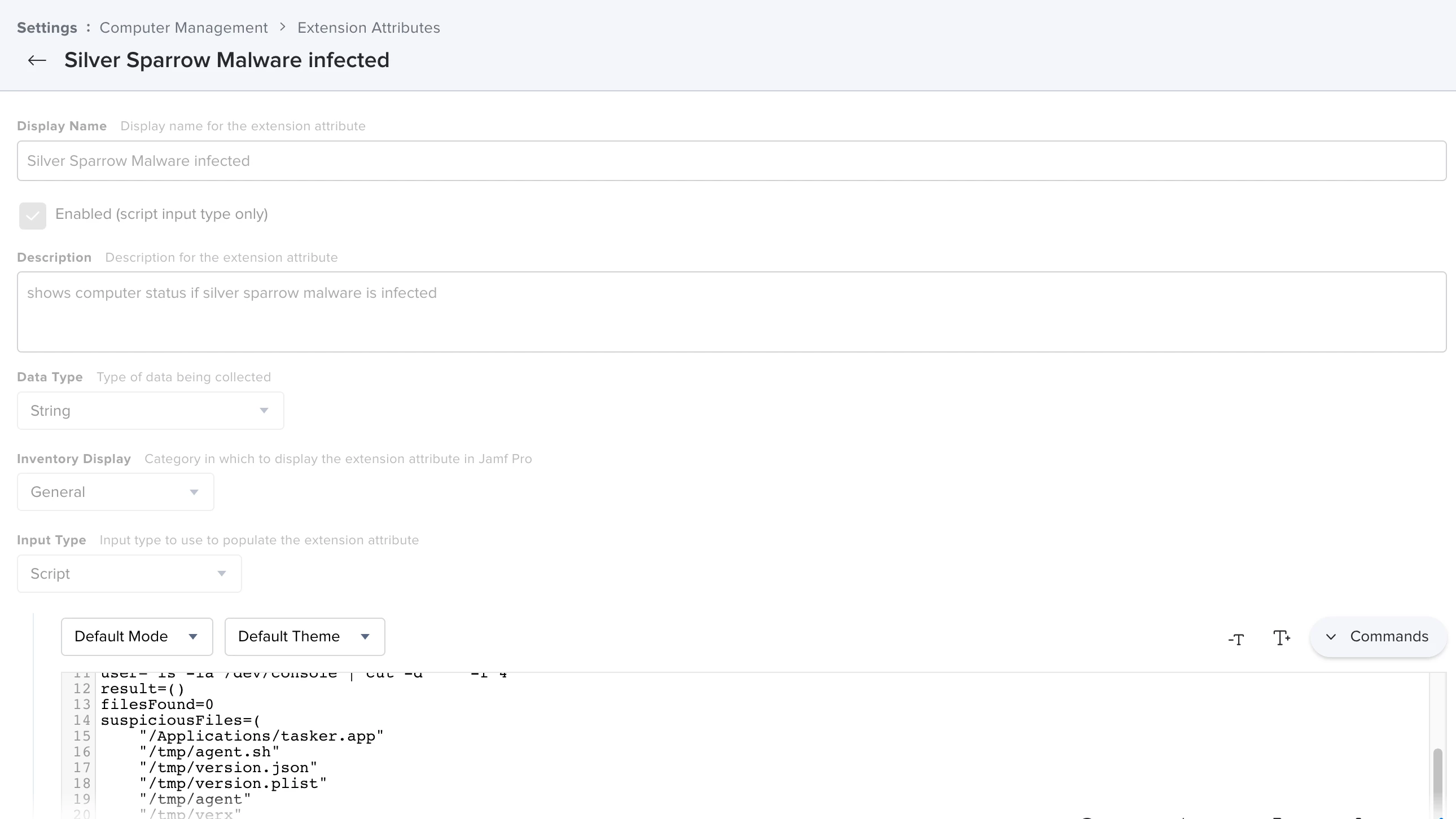

Can this EA be set as Default for the Script options?
To be more specific, just confirming the EA setup should look like this:
@acornetta Yes, exactly like that

Hi, so once Ive added the extension attribute and made it live how do I push this to clients to start reporting? Should I have written out a separate script? Or EA is fine?
Ahh it has started collection, to confirm I would see this under general > extension attributes and NOT under Extension attributes section on the left hand side of a computer record?

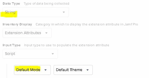

Hey @jonathan.rudge
The setting under Inventory Display allows you to set where on a computer's inventory display the results of an EA should appear.
For the sake of completeness: The dropdown menus at Default Mode and Default Theme are only there to customize the syntax highlighting and the appearance of scripts within the Jamf Pro interface. These settings have no effect on the functionality of a script ;-)
