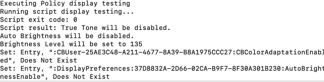

Thanj you.  Everytime I run it manually for testing I get the following results and nothign changes
True Tone option will not be changed.
Auto Brightness option will not be changed.
Brightness Level will not be changed.

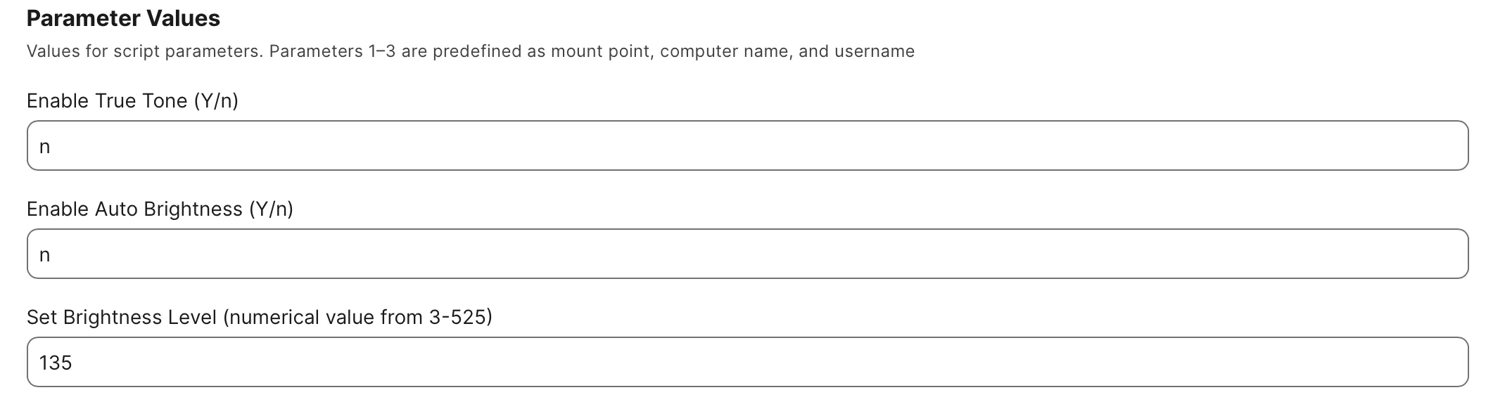

Are you setting the parameters in the script in the policy?
duh!!!  thanks. that was it.  however the when running the script, the settings change for a split second then revert, even when killing the corebrightnessd and Windowserver processors.  Any thoughts on that?
This is the script result

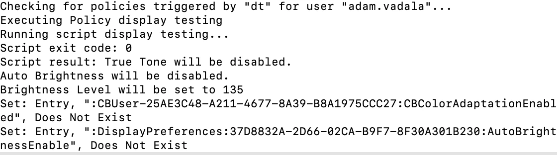

Understood.  thank you.  by chance did you see the screenshot I posted with the error message?

Thank you. unforntuately I cannot get it to work.  it disables true tone, the screen color changes, but then in a couple seconds reverts back.

Yep..same as the screenshot above that @kacey3 posted.
