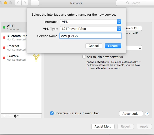

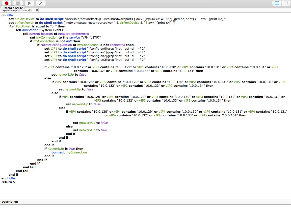

Can I have help with this script please?
I have this VPN application (AppleScript) to redirect students's traffic to our Watch Guard from home but the application pop up every minutes for some students. Anyone knows why the pop up or what I am missing? I have the application located /User/Library/ApplicationSupport/Jamf. And the same application is located in the login Items.
