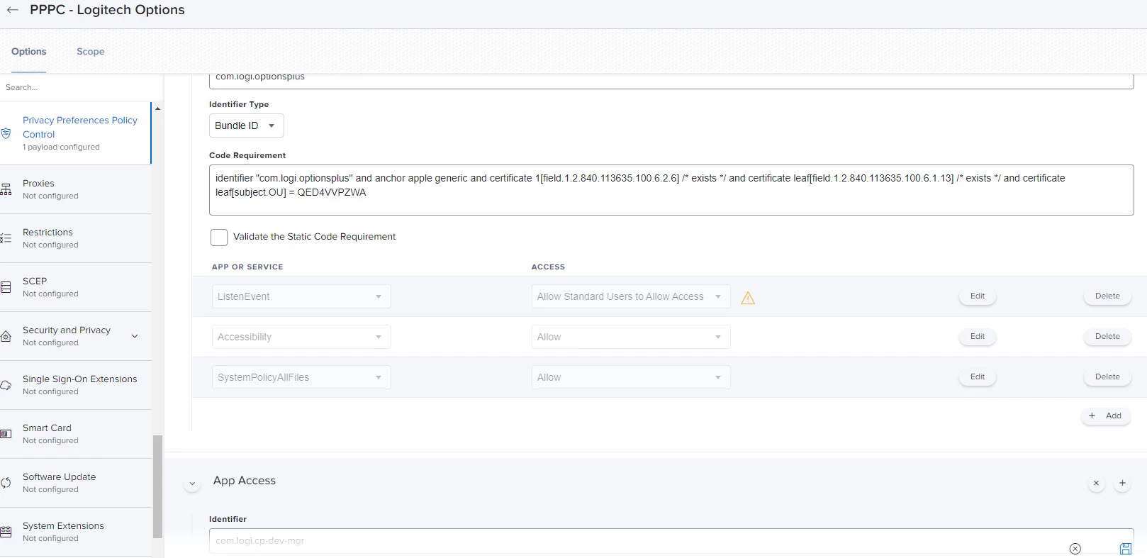

My guess is there is a different bundle Identifier needing Accessibility. As a example just to make Logitech Options work it uses 3 different Identifiers.

I saw references to some other issues with PPPC with Accessibility specifically.  Those references said that while the Preferences panel shows the permissions not enabled for the application, the functionality works as expected.  I tested it and found that to be true.  Scrolling Capture thinks it doesn't have permission, and clicking to set it opens the Accessibility PPPC panel showing the toggle not enabled for Snagit.  But within Snagit, when I perform a Scrolling Capture it works as expected.  So the Configuration Profile I published seems to work, it just displays incorrectly in the Preferences panel.
The only problem for us with regard to Snagit is that since it is displaying wrong, Snagit thinks it doesn't have the right permissions therefore prompts the user to change the permissions when that is unnecessary and the user doesn't have permission to do so.

I know this is an old thread, but just in case anyone gets it via a search, I too was running into this. There is another app within the Snagit.app (inside /Contents/Library/Loginitems) called SnagitHelper202X that you also need to create an entry for in your Configuration Profile to allow the Accessibility option.
