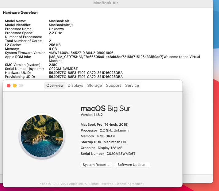

Ok, so, my turn to bang my head against the wall.  Been picking away at this all night with little to no success...  Using newest Fusion (Professional Version 12.2.1 (18811640) ).  VM is Big Sur 11.6.2.   I have edited the .vmx file with everyone's different suggestions, to no avail.
Using URL enrollment...  https://<instance>.jamfcloud.com/enroll
It will push the MDM Profile, but never the rest...
Any new thoughts around this?
Thanks!

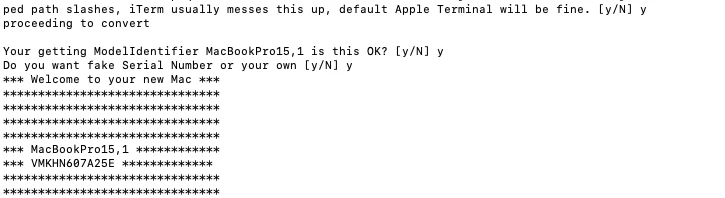

Yeah, manually editing the file never worked for me either. Thankfully,
this script works like a charm: https://github.com/zackn9ne/make_jamf_vm
Good luck!
-hm80
Still no go... I am not sure what the hang up is.... Any further thoughts?   What process do you follow to create end to end?
Does the script successfully run?  I always choose a random s/n which works for me.  I create a new VM with my OS of choice, immediately shut it down, quit VMWare, run the script, then launch the new VM and enroll it.
Successfully ran the script.  can confirm in the VM running and with a cat of the .vmx file.     Are you NAT'ing your VM IP or bridging it to the local network?  ( I have tried both, to no avail)
I Bridge and choose the name of my connection (Wi-Fi in my case) instead of Autodetect.
Does not work for me. It adds the hw.model but does not add a serial number
