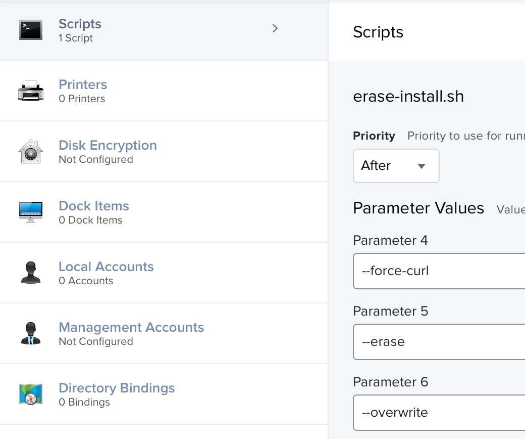

There's no package.  The script will download the installer.  You copy the script from the repo, and paste it as a new script in JAMF.  Then create a Self Service policy and use the parameters specified in section 2 of this part of the Wiki.
https://github.com/grahampugh/erase-install/wiki/8.-Use-in-Jamf-Pro
For example, I have a policy that will download the latest production version of macOS, overwrite any existing installer, then format the hard drive and re-install the OS.  My parameters are:
Parameter 4 --force-curl
Parameter 5 --erase
Parameter 6 --overwrite
Parameter 5 --erase
Parameter 5 --erase
