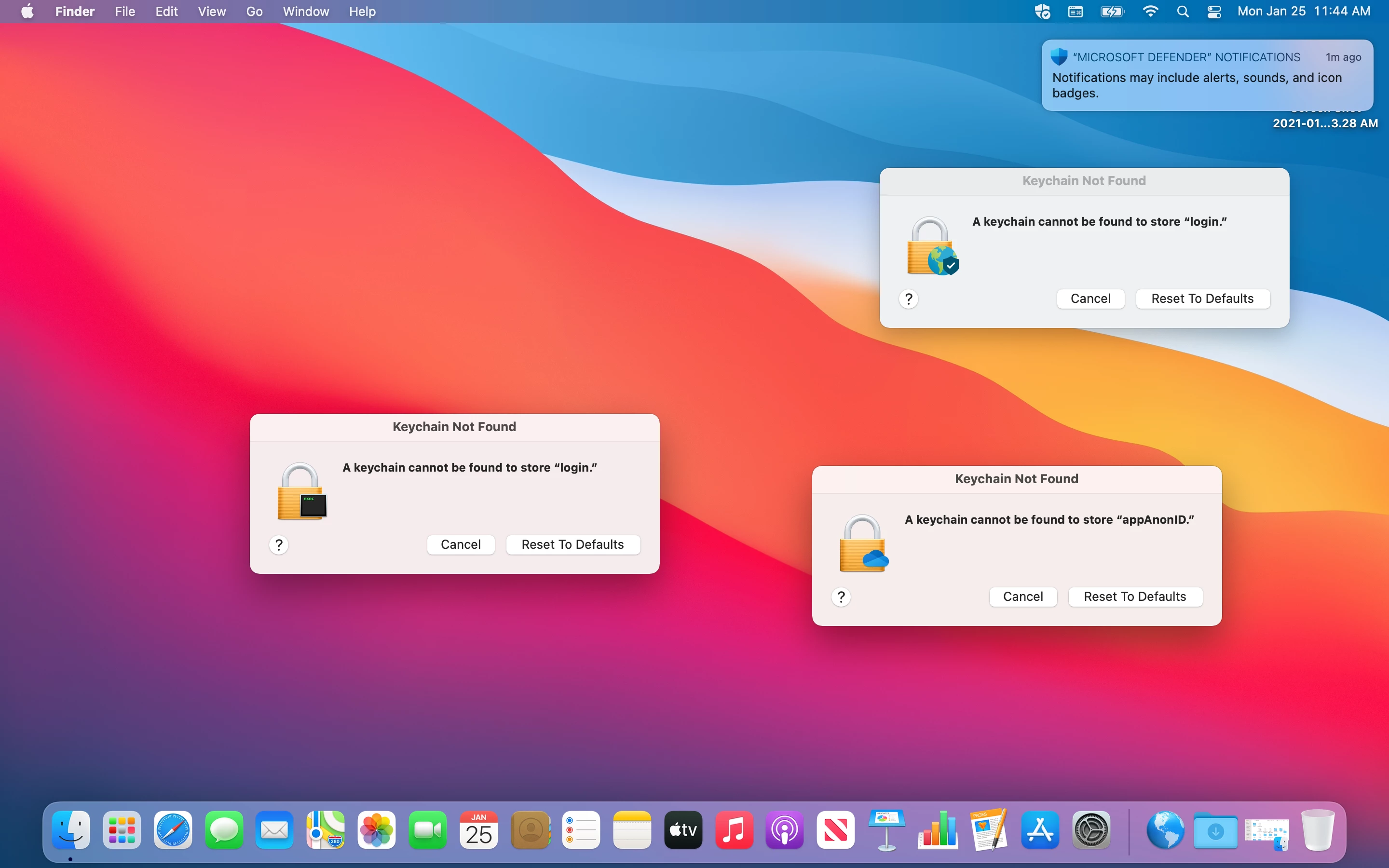

Hi everyone,
I am seeing a few issues after upgrading an enrolled and configured device from Catalina to Big Sur. Upon first login for a user, we get three or four keychain pop-ups saying the keychain could not be found (I would think that there is no keychain for a new user logging in for the first time).
We also have been seeing that it is picking up our wireless settings correctly, however, it is not auto-connecting (despite it being marked as auto-join). I have to manually select the wireless SSID for it to connect on each reboot. Also, when I log off, it disconnects from that wireless and I cant click the wireless icon on the login screen to connect to anything.
Is anyone else seeing this or know of a way to fix it. Is there something that changed with Big Sur that I need to update in my policies or config profiles on JAMF Pro?

No solution... I only noticed that after hitting "Reset to Default" for each keychain prompt and then rebooting, it doesn't prompt anymore. It appears to only prompt upon the first login when on Big Sur, but not on subsequent logins.

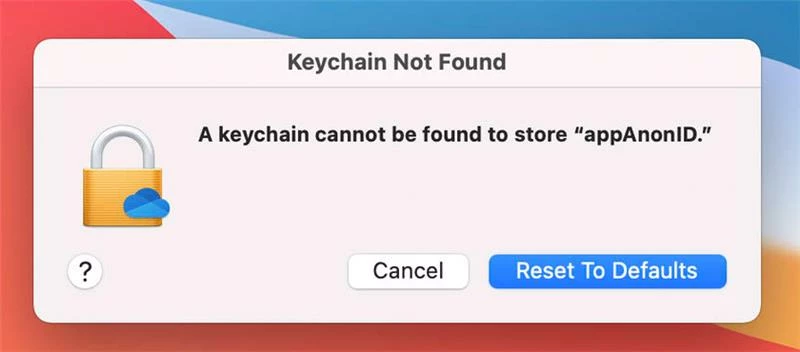

I am seeing this issue a lot on 11.3.1 (dont recall seeing it on earlier versions of macOS Big Sur). Clicking "Cancel" works for me somtimes (aand subsequent reboots/logins are fine).
We have 1 new M1 MacBook Pro running 11.2.3 with this issue as I type this post.
I'm guessing this is some sort of race condition in which apps/services are attempting to write to the Keychain before it is created?
@tyler.petro Are you suggesting that your Wi-fi and Login Keychain issues are related directly?
(My screenshot is an example of a MS app trying to create a Keychain entry (OneDrive), but several apps will display the same errors)

UPDATE: This is a known issue. Apple has fixed it as of macOS 11.4 beta 1 (according to release notes).
I just tested macOS 11.4 beta 3 and can confirm the issue is resolved for me.

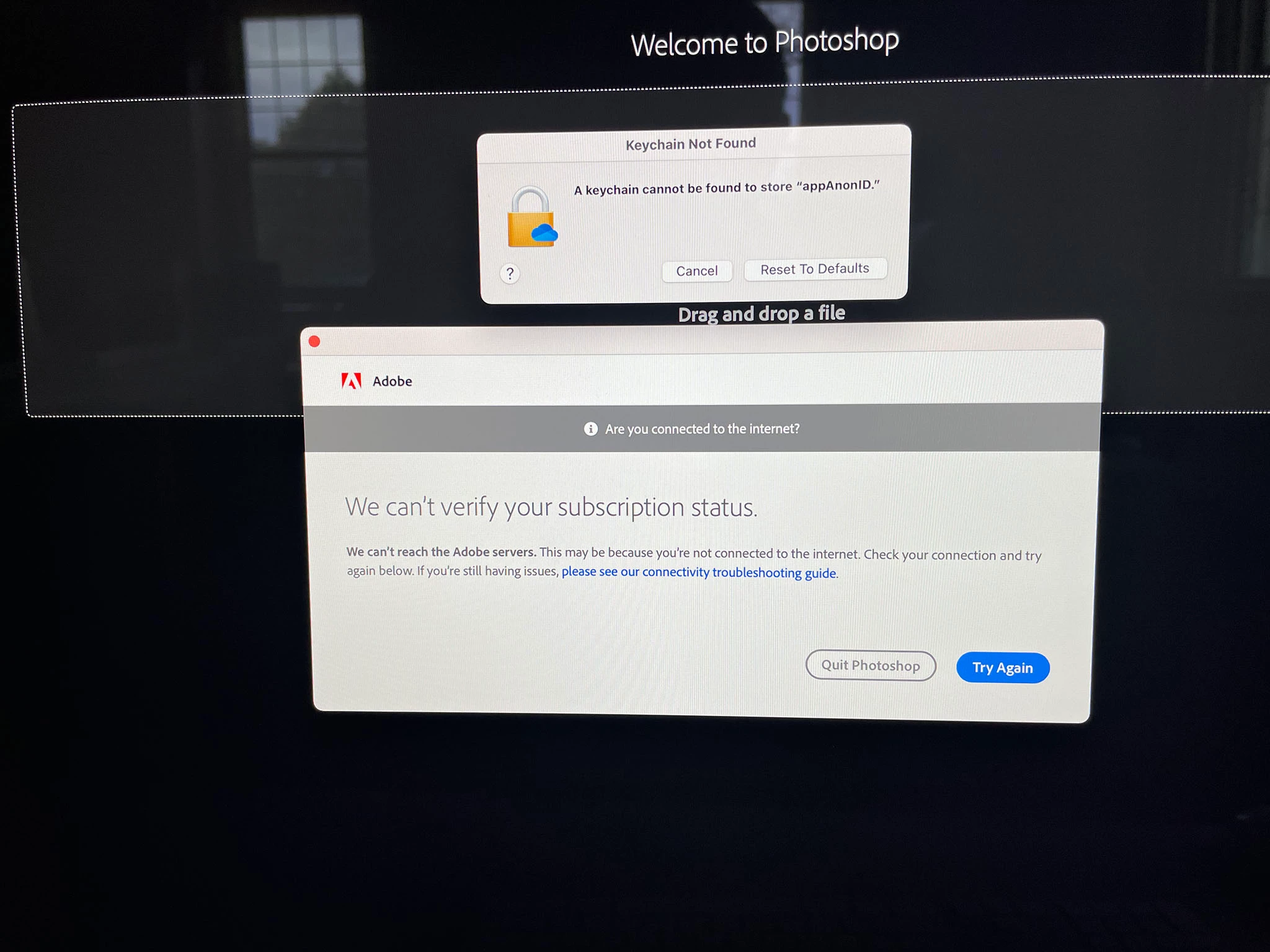

Any solution to this? I'm having this issue as well. It seems on accounts that show me the error (which are all of them besides the one admin account I created initially and have been using on and off for the summer as I prep our student labs). Furthermore I'm wondering if this is causing Adobe products to not be able to launch somehow by not allowing the Adobe Application Manager to realize the computer is connected to the internet. All accounts that show this error will not let Adobe connect, the one account that doesn't show the message works fine. Any thoughts?
