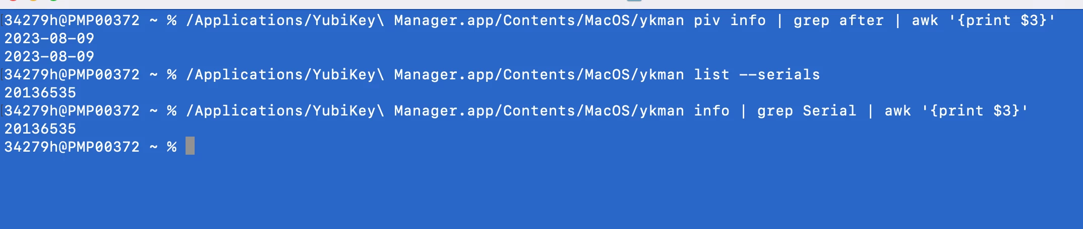

I can ran these commands in terminal with correct output.

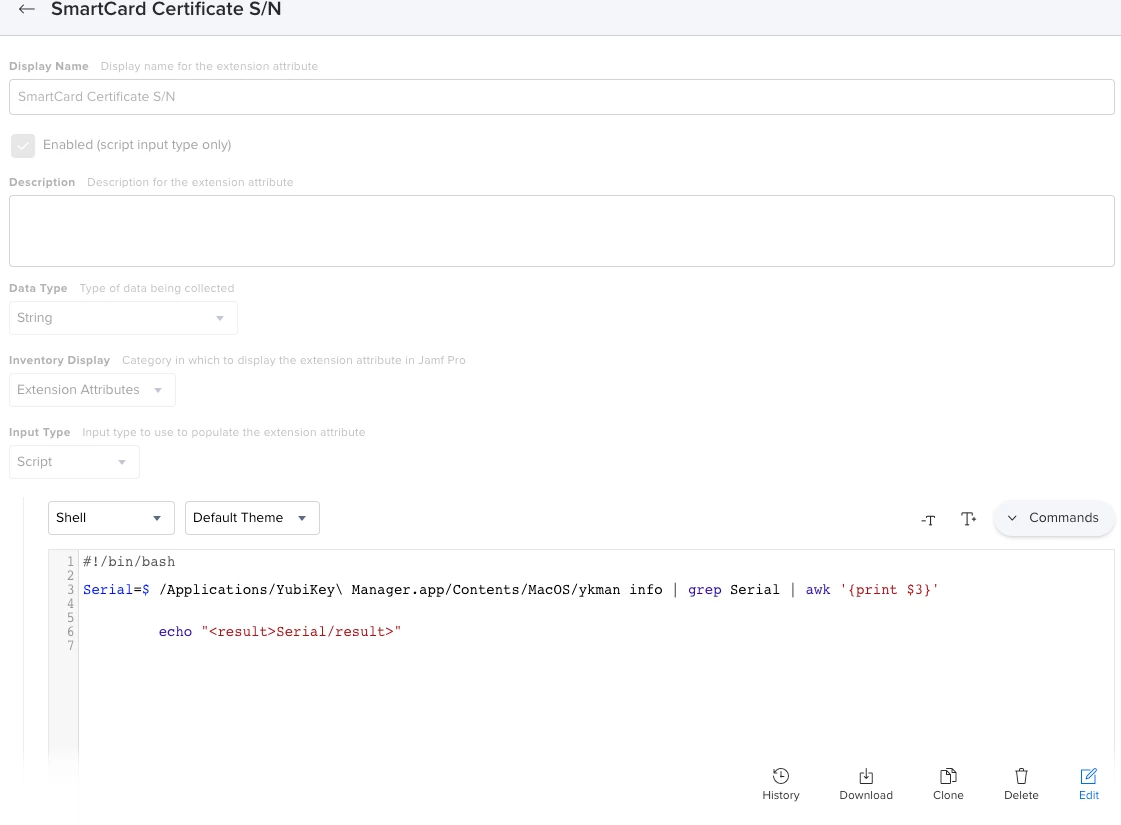

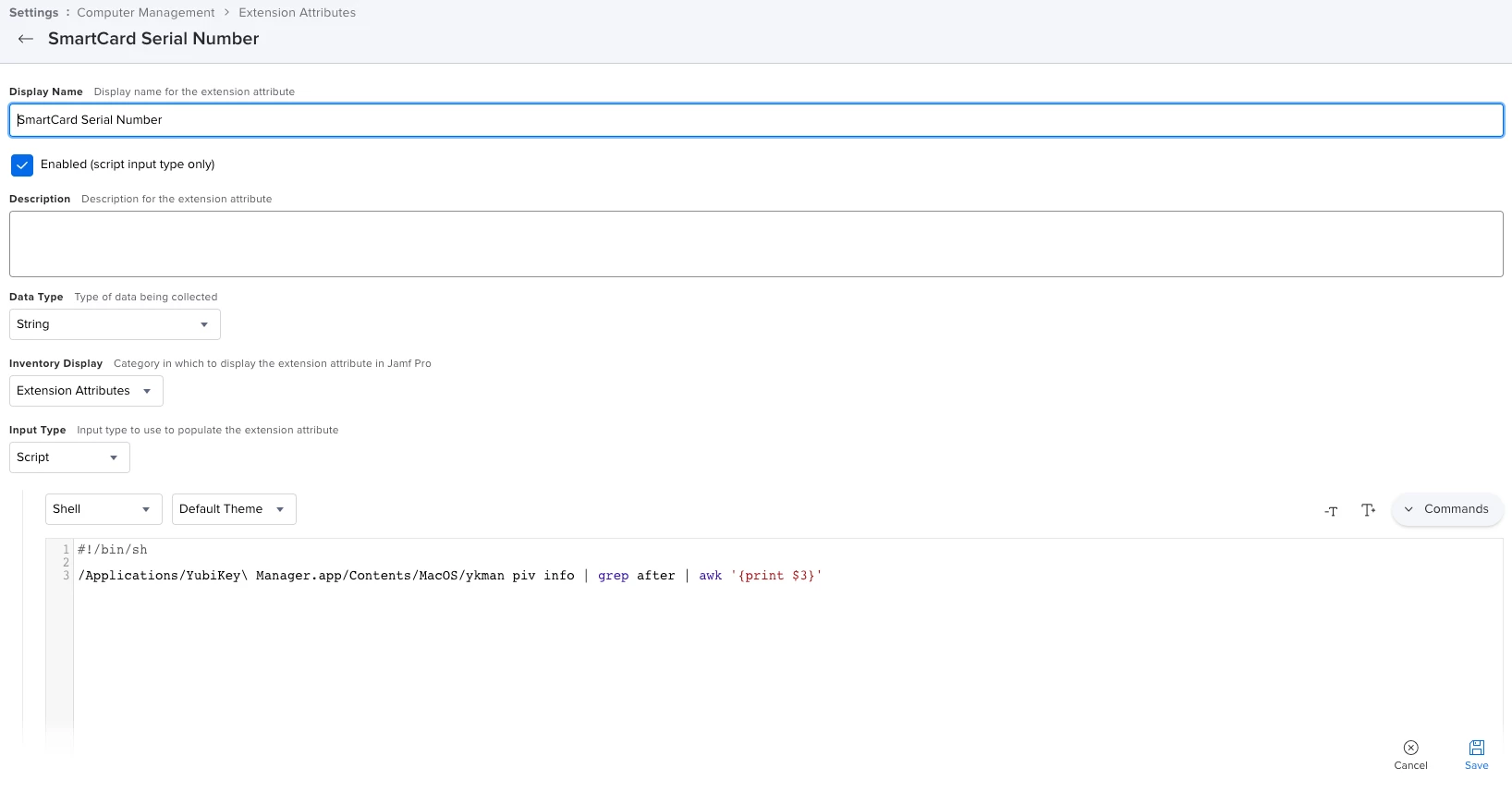

However, am not able to translate this in valid EA, any idea ?
This EA is not working. What have is missed?
 this works in terminal as sh file not as EA!

@Eskobar I got the EA Working.
Use the following installer and the following EA:
https://github.com/Yubico/yubikey-manager/releases
Current Version at time of this message:
https://github.com/Yubico/yubikey-manager/releases/download/5.0.1/yubikey-manager-5.0.1-mac.pkg
if [ -e /usr/local/ykman/ykman ]
then
Serials=$(/usr/local/ykman/ykman piv info)
echo "<result>$Serials</result>"
else
echo "<result>NotInstalled</result>"
