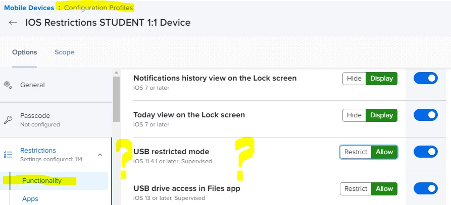

ARGH. So - I want to allow a USB internet Share from caching server, or an ethernet lightning dongle.
What should I set in the attached image - Why are these settings having such counter intuitive names and options with no explanation notes?!?

I have USB restricted mode set to Restrict on all our deployed iPads via a config profile and it allows the use of a USB-Ethernet adapter connected to the iPad via the Apple Lightning to USB 3 Camera Adapter and power from an iPad charger as the accessories draw more power than the iPad can provide. I wish I never had to use it, but I run into similar situations and this works flawlessly about 9/10 times.
@rtown56 I don't think USB restricted mode policy will allow USB Internet Share if iPads are locked or disabled. It might need to Trust the laptop you are connecting to so for the purpose of unlocking iPads without WiFi, it might not work. Dongles on the other hand do not require Trust permission so they just work at the lock screen once you "Restrict" USB restricted mode.
Following - we have now implemented this by adding Configuration Profiles -> Restrictions -> Functionality -> USB restricted mode and turning it to Restricted. We have tested on a handful of devices here and it worked successfully to allow us to get ethernet access and clear the passcode. Thanks for the tip!
