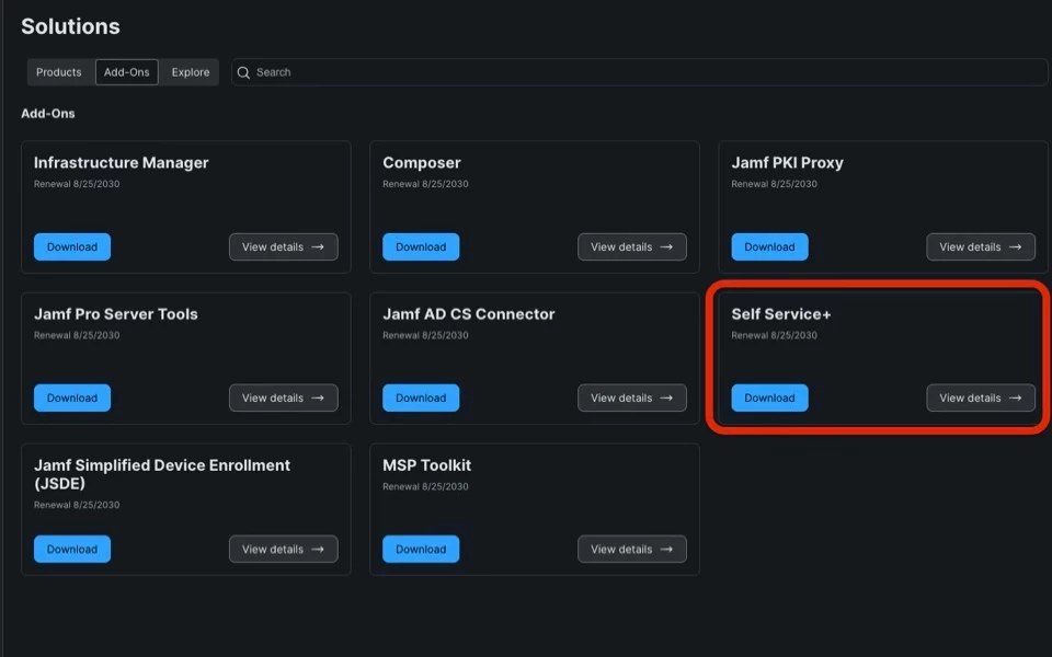

Step 1 - Download the Self Service+ PKG
  1. Download the Self Service+ installer package from Jamf Account (Add-ons)
  2. Upload the PKG to Jamf Pro (Packages)

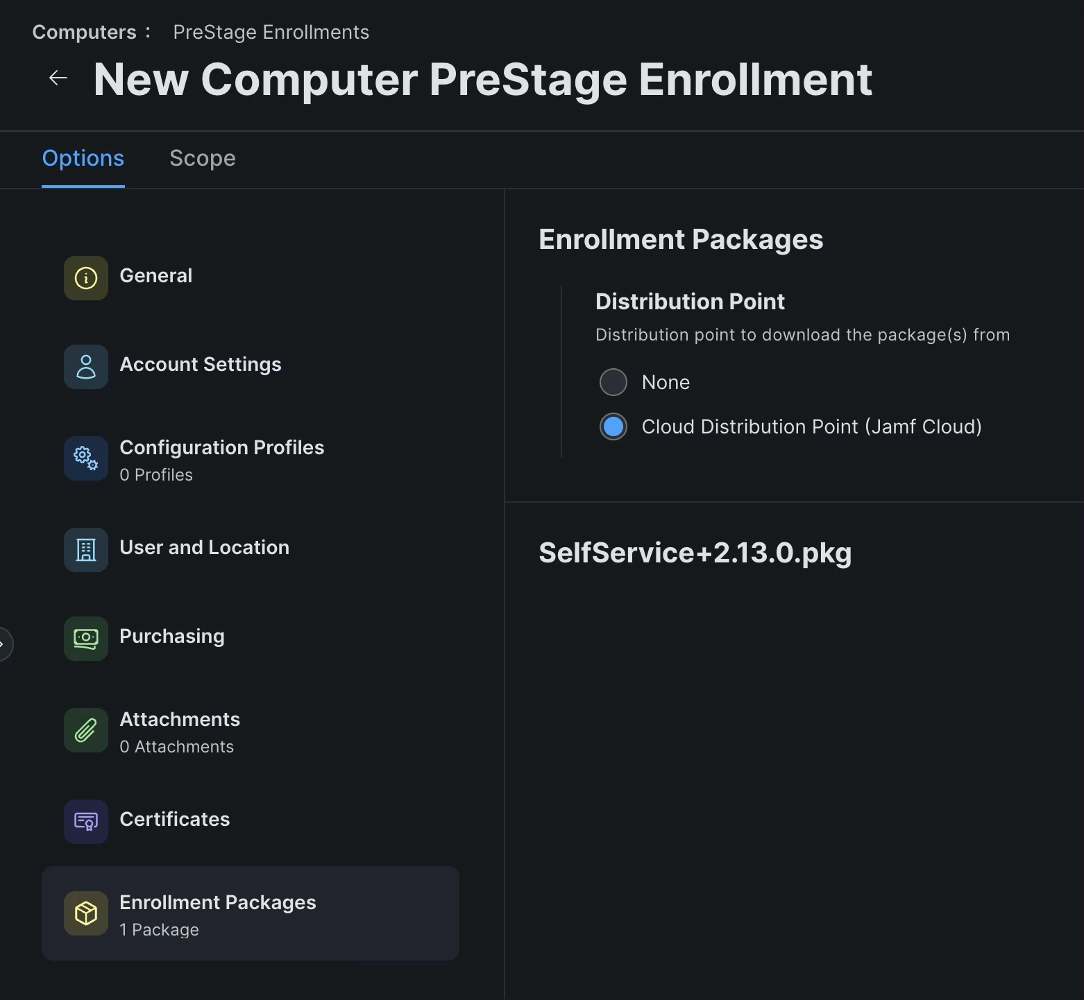

Step 2A - ADE: Add Self Service+ to PreStage Enrollment packages
  1. In Jamf Pro, open your macOS PreStage Enrollment
  2. Add the Self Service+ PKG to Enrollment Packages
  3. Save
Why this matters: PreStage staging installs Self Service+ during enrollment without relying on global enablement that can collide with macOS Onboarding.

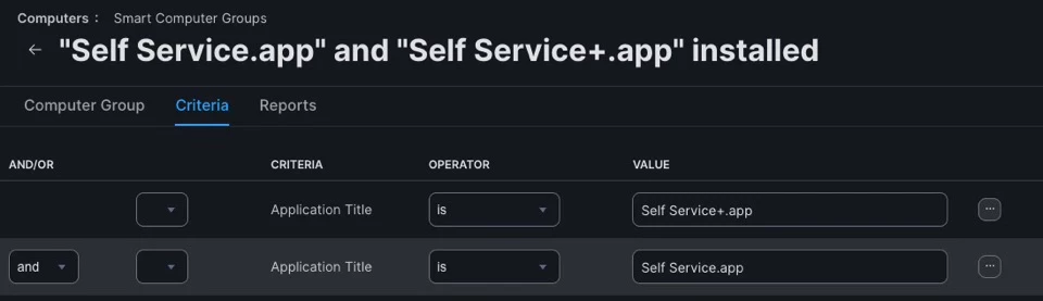

Step 3.1 - Create a Smart Group: “Has both Self Service and Self Service+”
  1. Create a Smart Computer Group
  2. Criteria example:
    • Application Title has Self Service.app
    • AND Application Title has Self Service Plus.app (or your exact app name as reported)
  3. Save

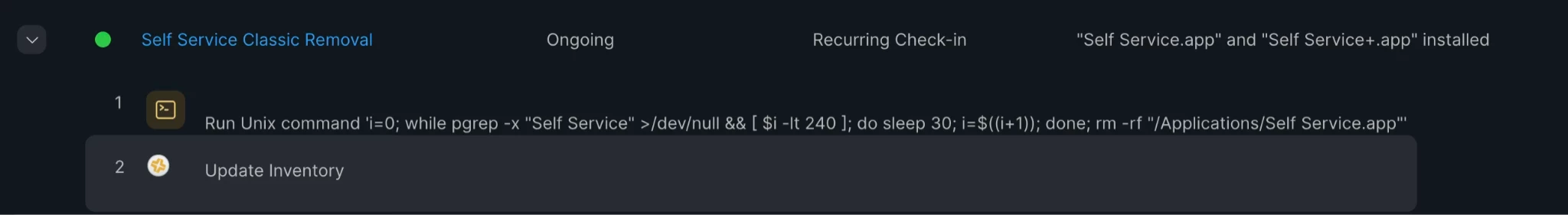

Step 3.2 - Create a cleanup policy: “Remove classic Self Service”
  1. Create a policy scoped to the Smart Group above
  2. Add a Files and Processes payload to remove the classic app:
    • Add the following in the command field in order To avoid removing the classic Self Service app while it is still running or during macOS Onboarding, wait until the application is no longer running before removing it (with 2 hours timeout):
      • i=0; while pgrep -x "Self Service" >/dev/null && [ $i -lt 240 ]; do sleep 30; i=$((i+1)); done; rm -rf "/Applications/Self Service.app"
    • Alternatively, if you don’t worry about removing the old Self Service too early you can simply use the command:
      • rm -rf "/Applications/Self Service.app"
  1. Add Maintenance:
    • Enable Update Inventory
  2. Execution frequency: Ongoing
  3. Save
Why inventory update matters: it refreshes the application inventory so the Mac drops out of the Smart Group immediately after removal.
Why Ongoing? In environments that rely on macOS Onboarding, the legacy classic Self Service installation setting must remain enabled for new enrollments, which means Classic Self Service may reappear on already enrolled Macs at a later time (for example, following a Jamf Pro upgrade). Setting the removal policy to Ongoing ensures the classic app is automatically removed again whenever it reappears. Once Classic Self Service is fully deprecated and no longer installed by Jamf, the execution frequency no longer matters.
Note: Application titles are used in the examples above for clarity and consistency with the screenshots. In production environments, scoping based on Application Bundle ID is often more reliable, as bundle identifiers remain consistent across languages and versions. Always validate identifiers against live inventory data in your environment.

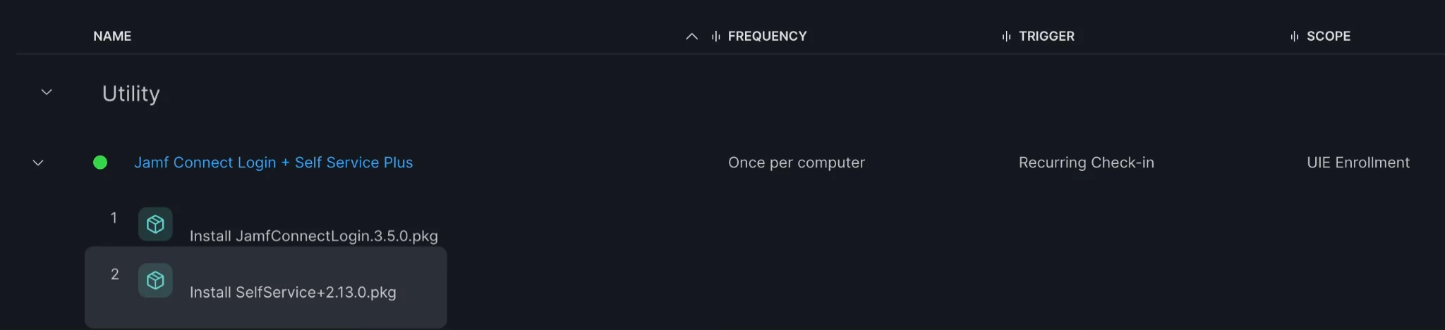

Step 3 - UIE: Deploy via policies
If UIE is used:
  1. Create a policy to deploy both Jamf Connect Login and Self Service+
  2. Control scope and frequency so both run once per computer
  3. Do not mix cleanup until Self Service+ is confirmed present

Step 4.1 - Create a Smart Group: “Has both Self Service and Self Service+”
  1. Save

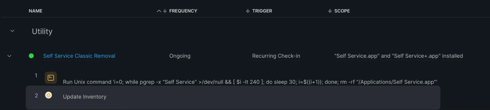

Step 4.2 - Create a cleanup policy: “Remove classic Self Service”
  3. Add Maintenance:
  1. Execution frequency: Ongoing
  1. Save

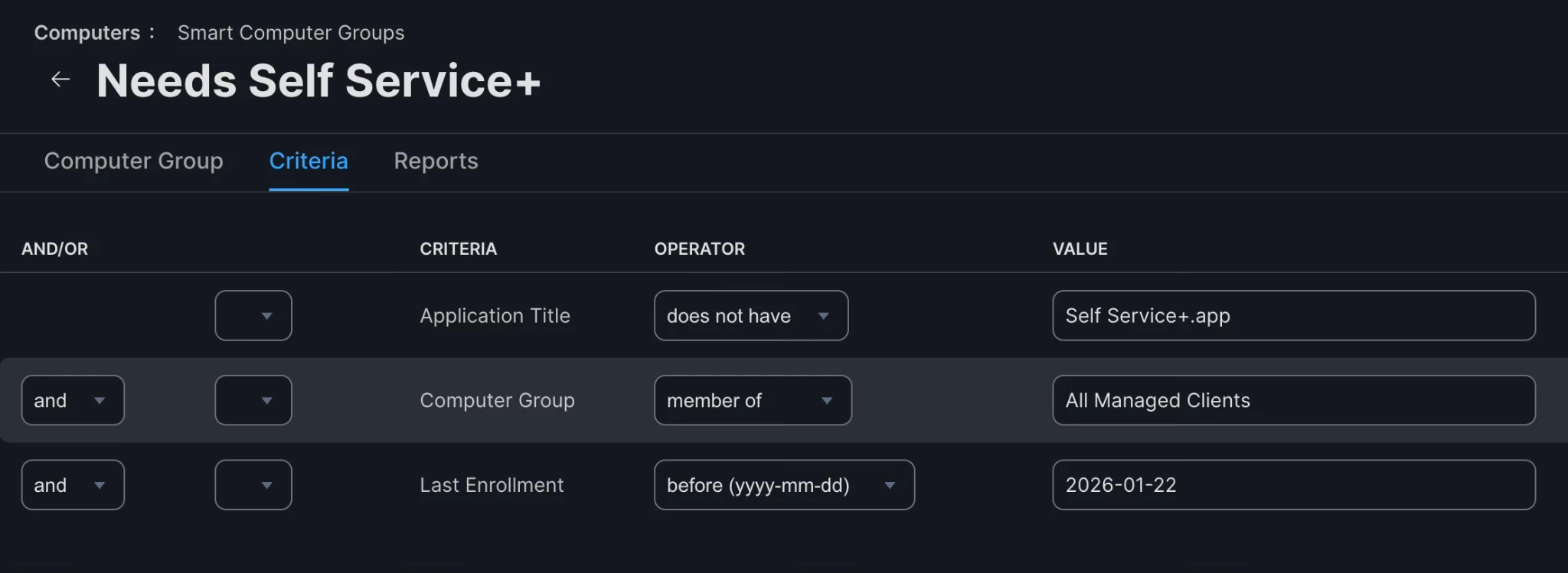

Step 1 - Create a Smart Group: “Needs Self Service+”
Example criteria:
  • Does not have Self Service Plus.app
  • AND is currently managed
  • Optional: Enrollment date before a chosen cutoff (to separate from newly enrolled Macs)

Classic Self Service keeps reappearing on already enrolled Macs
  • This behavior is expected in environments where the legacy Self Service installation setting remains enabled for new enrollments.
  • Ensure the removal policy is configured with an Ongoing execution frequency so the classic app is removed again whenever it reappears.
Why this matters:
This is not a failure state — it is the expected behavior until Classic Self Service is fully deprecated.
Unsure which Self Service deployment path applies to your environment
  • Revisit the option selection section and confirm whether you are dealing with:
    • New enrollments
    • Existing managed Macs
    • macOS Onboarding in active use
  • Avoid mixing deployment logic between options.
Why this matters:
Most migration issues happen when steps from multiple options are combined unintentionally.
In most cases, issues encountered during Self Service+ migration are the result of timing or sequencing, not incorrect configuration. Reviewing execution order usually resolves the problem without structural changes.

That’s a critical question. When you enable Self Service+ via the global toggle (Settings > Jamf Apps > Self Service+), Jamf Pro treats it as a built-in 'system' update.
Here is exactly what happens during the enrollment break:
  • The Conflict: The global toggle attempts to force-install and launch Self Service+ the moment the Mac reaches the desktop. At the exact same time, Jamf Pro macOS Onboarding is trying to initialize its own full-screen overlay to run your curated setup policies.
  • The Result: Because both processes are fighting for 'front-most' priority, the Self Service+ launch can 'crush' the onboarding window. We’ve seen cases where the onboarding UI either disappears entirely, fails to trigger the subsequent policy chain, or leaves the user at a blank desktop while policies are still running invisibly in the background.
  • The 'Safe' Alternative: By keeping the global toggle OFF and instead deploying Self Service+ as a PreStage Enrollment Package (as detailed in Option 1 and 2), you are 'staging' the app. This allows the macOS Onboarding process to maintain control of the user session, ensuring all your setup policies finish correctly before the new Self Service+ interface takes over.
In short: Manual deployment via PreStage gives you sequencing control, whereas global enablement creates a race condition between the app and your onboarding workflow.
