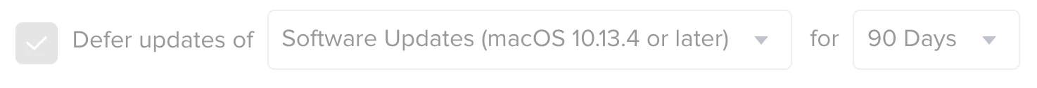

We have the 'Defer major updates' config profile in place, scoped to everyone:
but in every case it was there plain as day in the GUI tool, though not listed by softwareupdate -l, which just showed the 10.15.7 supplemental update.
More curiously, despite the fact that it has supposedly been deprecated. I've now successfully run softwareupdate --ignore "macOS Big Sur" on these machines, and it works. The gui tool went back to offering only the supplemental update.

Out of curiosity, why are you saying to defer Applications instead of "Software Updates" or the "Applications and Software Updates" options?
@terrydooher softwareupdate --ignore "macOS Big Sur" was brought back by Apple in the final updates of 10.13, 10.14 and 10.15, but only for computers enrolled with User-Approved MDM, and it will only ignore updates that are available at the time the command is run. So, as @dan-snelson suggested, it pays to combine it with some monitoring of what updates are listed via softwareupdate -l.
@sheltond3 Good spot, I put the wrong screenshot in. Fixed in OP :)

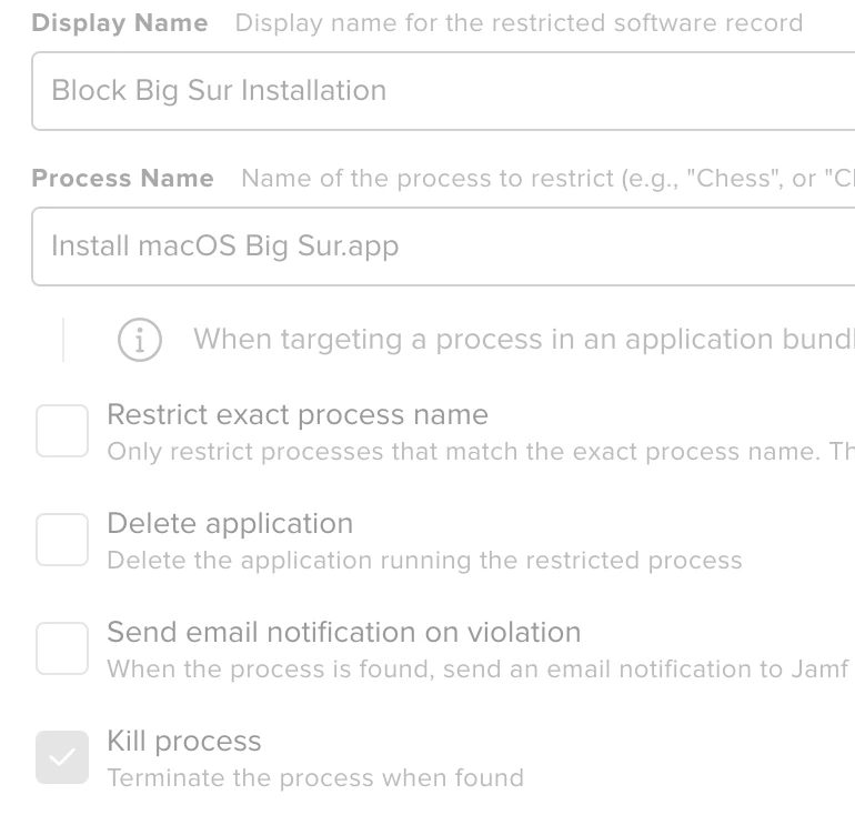

If you use a Restricted Software configuration with a Process name of "InstallAssistant" then the GUI for all recent macOS installers (definitely HS, Mojave, Catalina, and BS) will be blocked, yet you'll still be able to run a script like macOSUpgarde to run the installer via an approved workflow.
@sdagley We do have that already, though I'm using it to block the app:
Without the explicit match checked, as I understand it, this will also block the InstallAssistant (and other processes) contained within. I still see this as a fallback, however; I'm trying to remove visibility and make it not downloadable in the first place.

Combination of running "softwareupdate --ignore "macOS Big Sur" and restriction process of
Install macOS Big Sur.app has been working well for us.
