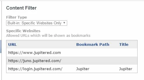

  • January 26, 2017
Unless I'm missing something, Apple Classroom will only allow single app mode, but will allow students to navigate away from a site in Safari. Using config profiles will allow whitelisting of certain domains with the content filter. In this case, Jupiter:
