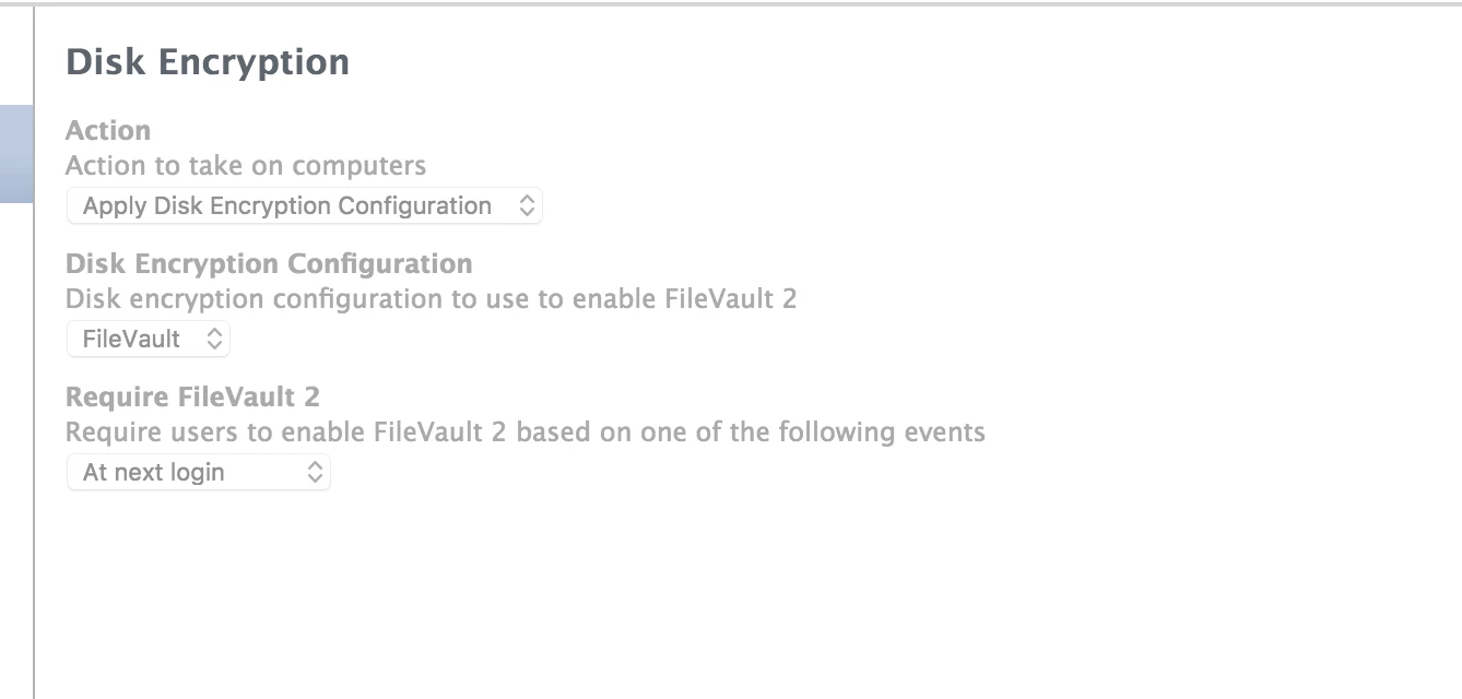

could you post a screen shot of your policy and filevault config?

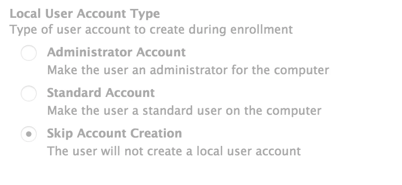

Actually we turned off the initial account creation in DEP. So the first person to login is the mobil account.
To be clear, I'm not talking about the DEP PreStage user, I'm talking about the user that is created when you log in for DEP.
Yes we turn that off.
Meaning initial setup, not during enrollment.
Win? I'm just trying to understand how you're enrolling your machines.

If I run the same policy on a new machine it works just as designed, but on upgraded machines it asks the user to authenticate at login, then tells them to FV2 then a message about running in the background. But NOTHING happens. Everytime you reboot it shows those messages but never actually triggers the FV2.
