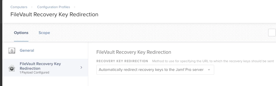

@McAwesome Thanx for the info. This is happening on accounts that have never had FileVault enabled. Could it possibly be occurring due to a policy I have enabled to redirect FileVault Recovery keys that is enabled on all macOS devices that is prompting it? ( aka FileVault Recovery Key Redirection).
Only 1% of staff utilize it now so I suppose I could disable to see if that makes this message go away. We block on student machines but the redirection is enabled for all.
@MikeT That policy shouldn't work on 10.13.4 devices. I have it not scoped to my 10.13.4 devices for the new policy in Filevault. Still is happening.
