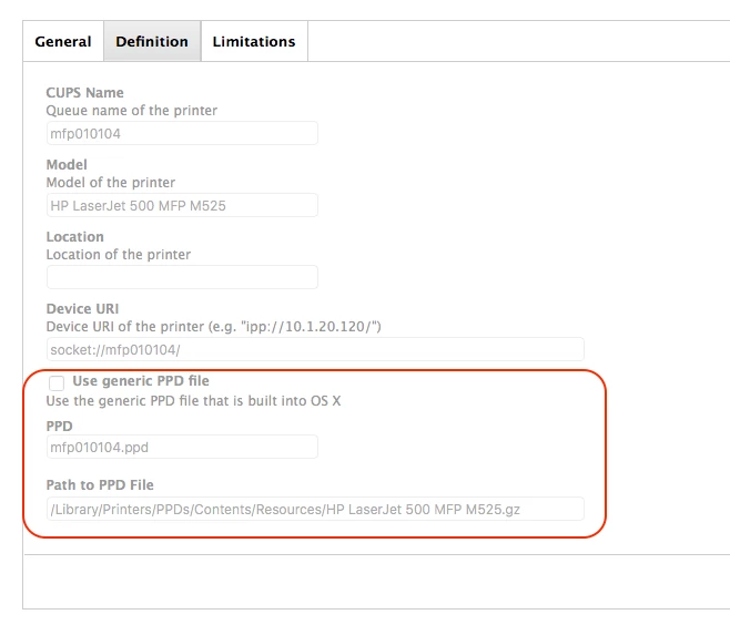

For those of you who manage network printers in the JSS...
Just curious - have you had any luck using the JSS's "Use generic PPD", or do you set the exact path to the manufacture's PPD file?
Most of my printers are failry plain jane HP printers that dont require custom trays, duplexing, etc.

Since my JumpStart a year ago, I have manually configured every setting possible in the JSS and made sure that all Macs have the same HP printer driver packages installed. Very consistent here.
Im wondering if I have been "overmanaging" them. So far I havent had any printer isssues at all (in terms of both the printer objects themselves and the related JSS printer mapping polices, etc)
But now that HP appears to be releasing future PPDs from their craptastic "Easy Start" app, Im wondering how easy it will be to manage printers going forward.

Im just using a built-in JSS printer Policy payload and the Appple/HP printer package (https://support.apple.com/kb/DL1888?locale=en_US). Combine those with smart goups that keep track of which printers are required by which departments and Im golden. Its failry simple here: Each department basically gets dedicated 2 printers (and dont share with other departments).
