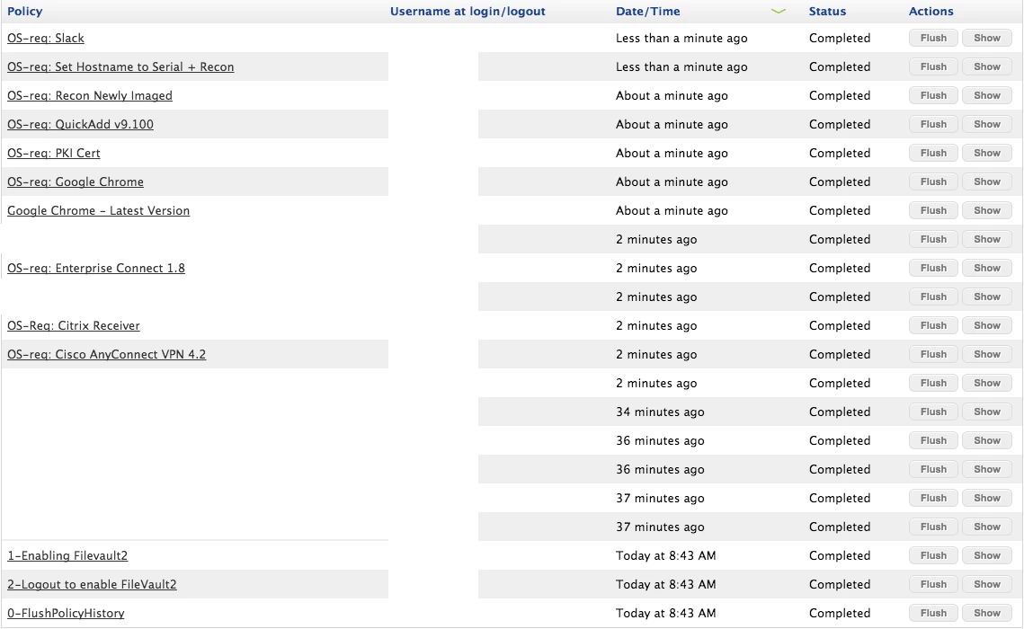

Im seeing this issue after updating to JSS 9.101
After enrolling a laptop via DEP. Policies that have .pkg do not run until about an hour after enrollment.
I do a sudo jamf recon, then sudo jamf policy, but it says "No policies were found for the "recurring check-in" trigger"
If i look at the Management Tab - Policies and it lists all the policies that should be running at check-in.
I noticed this mainly on the new touch bar model macs. But have seen this happening on older models also. Anyone else experience this??
