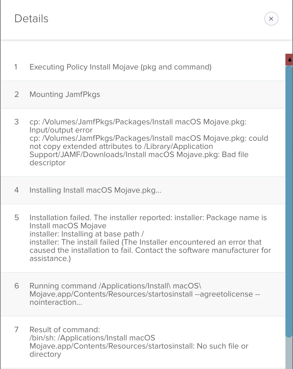

What I'm finding is that on some iMacs the install is failing or getting stuck.
I've attached one error message.
Any ideas or recommendations.

@psherotov In Step 3 you have an error that the installer package couldn't be downloaded from your DP to the target Mac so it's game over at that point. If it consistently fails on the same machine I'd suggest checking the permissions on the Jamf downloads folder.

@sdagley Thanks! We have Avast and it's probably blocking access, I've excluded that directory and I'm going to test some more.
