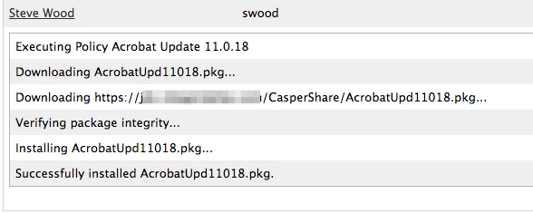

If you've pushed FPU via a policy, you can go into the logs of that policy to pull the appropriate URL to curl from. Here's an example of what I'm talking about:
If you are thinking of doing this while booted from NetBoot, you would want to throw in some logic to discover where the specific partition you want to install on is mounted. Obviously it will be /Volumes, but to be safe you want to pull the correct volume. That gets a little trickier, but I'm sure there are examples on the web or maybe even in Jamf Nation showing how to do this using diskutil. You'll need to use that path in the installer command replacing -target / with the appropriate path. For example -target /Volumes/Macintosh HD/
