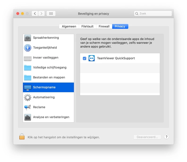

I recently discovered that a standard user is able to check the mark for 'Screen Recording' in Security & Privacy.
Is this a setting in JAMF or is it always been like this?
Like @admin.mcp said, standard users should be able to check this box for applications they have the permission to run.

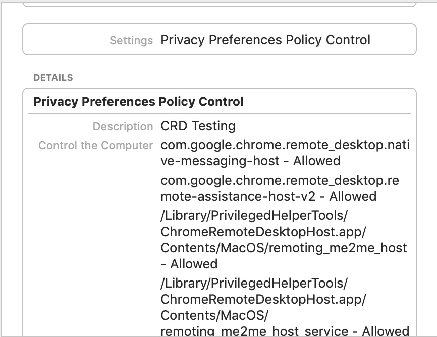

We got this working by creating a PPPC profile for the following app within the Chrome Remote Desktop app with Accessibility set to Allow.
/Library/PrivilegedHelperTools/ChromeRemoteDesktopHost.app/Contents/MacOS/RemoteAssistanceHost.app
We also allowed Accessibility for all 4 apps/executables within that MacOS folder just in case.

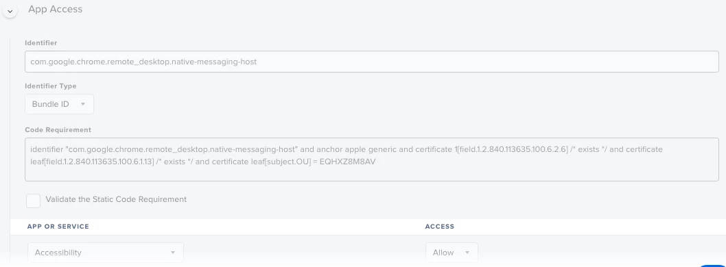

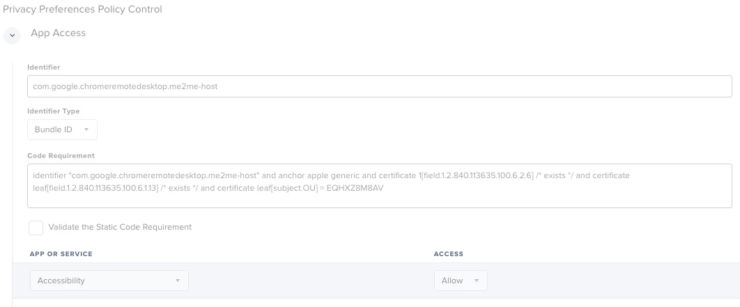

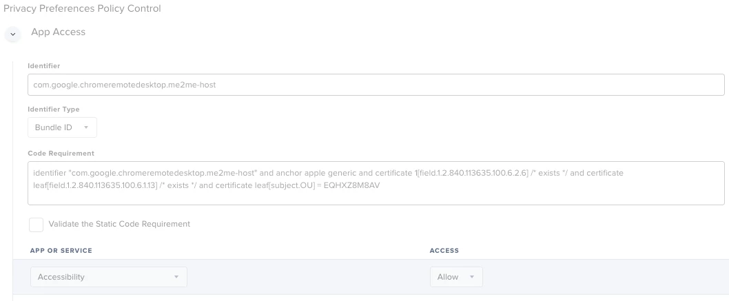

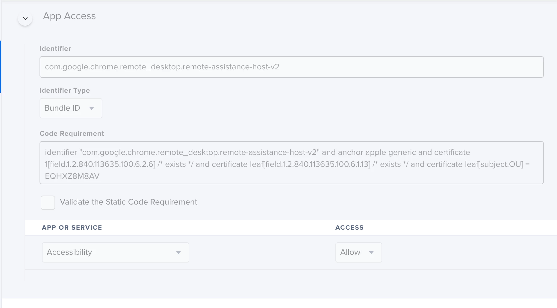

Glad to have found this thread. Based on the response above from @jsquires3, was able to create the correct PPPC for Chrome Remote Desktop Host and the two apps contained in the contents:
com.google.chromeremotedesktop.me2me-host
com.google.chrome.remote_desktop.native-messaging-host
com.google.chrome.remote_desktop.remote-assistance-host-v2
Thanks!

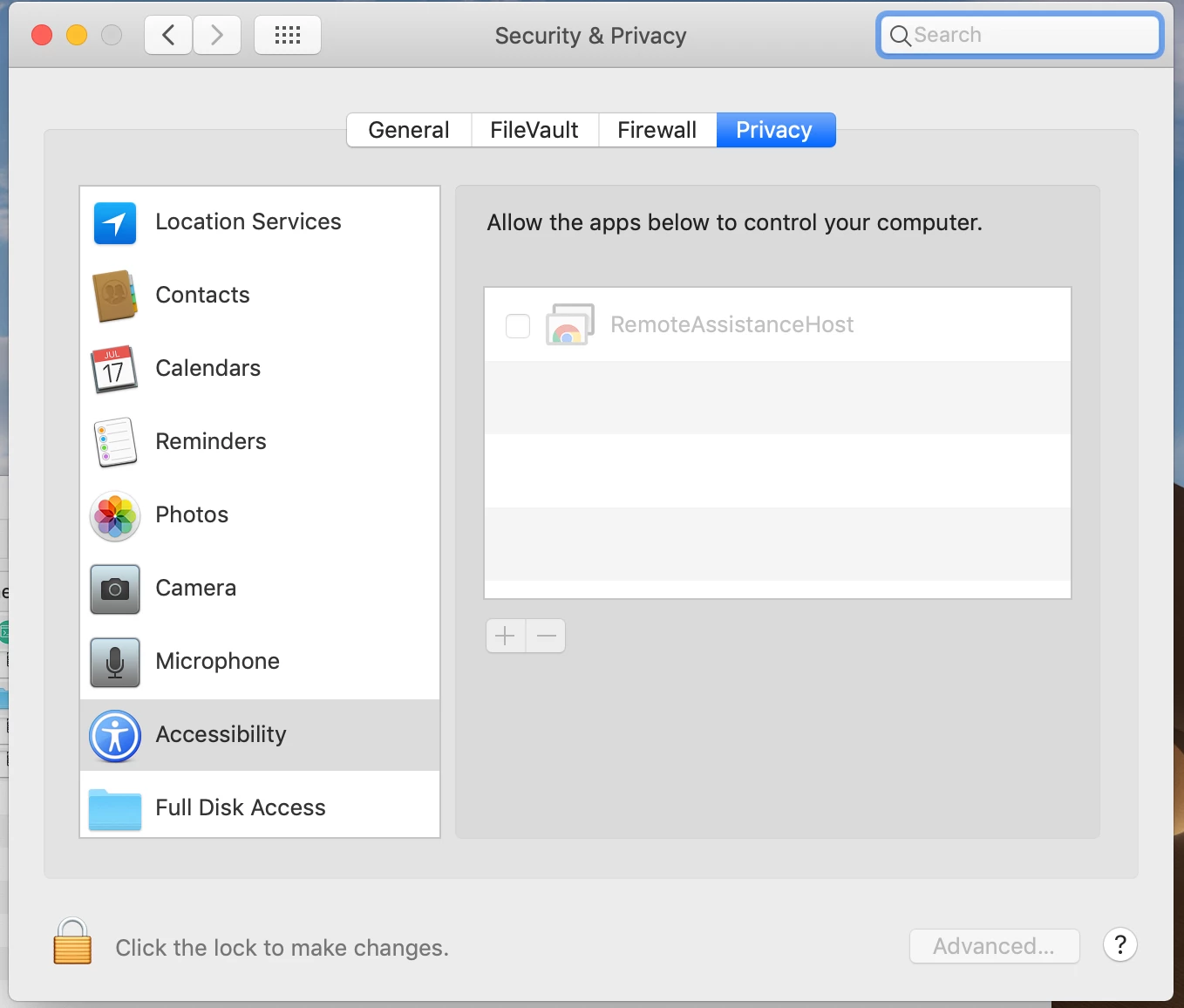

Interestingly when I did the same thing with the PPPC utility, it did put the entries into the pref pane, but it left them all unchecked. I'm assuming this is because there is no Allow option under Screen Capture in PPPC Utility. Does allowing Accessibility somehow allow you to work around not having Screen Recording/Capture set to allow?
Additionally, the screen recording permissions are definitely greyed out on standard accounts for us. Not sure why this is different for us.
Nevermind my response above. I see that Screen Recording is only for Catalina, and that since the local user has to enable it, there's now allow checkbox. 99% of my users are on Mojave, so I'll use accessibility for now. Unfortunately though, I'm not having much luck with that either.

I'm not having any luck either. The remote assistance option is still unchecked after the profile is installed. I added all 4 files from/Library/PrivilegedHelperTools/ChromeRemoteDesktopHost.app/Contents/MacOS/ folder and I verified that the profile was installed correctly to my test computer. Is there something that I am missing?

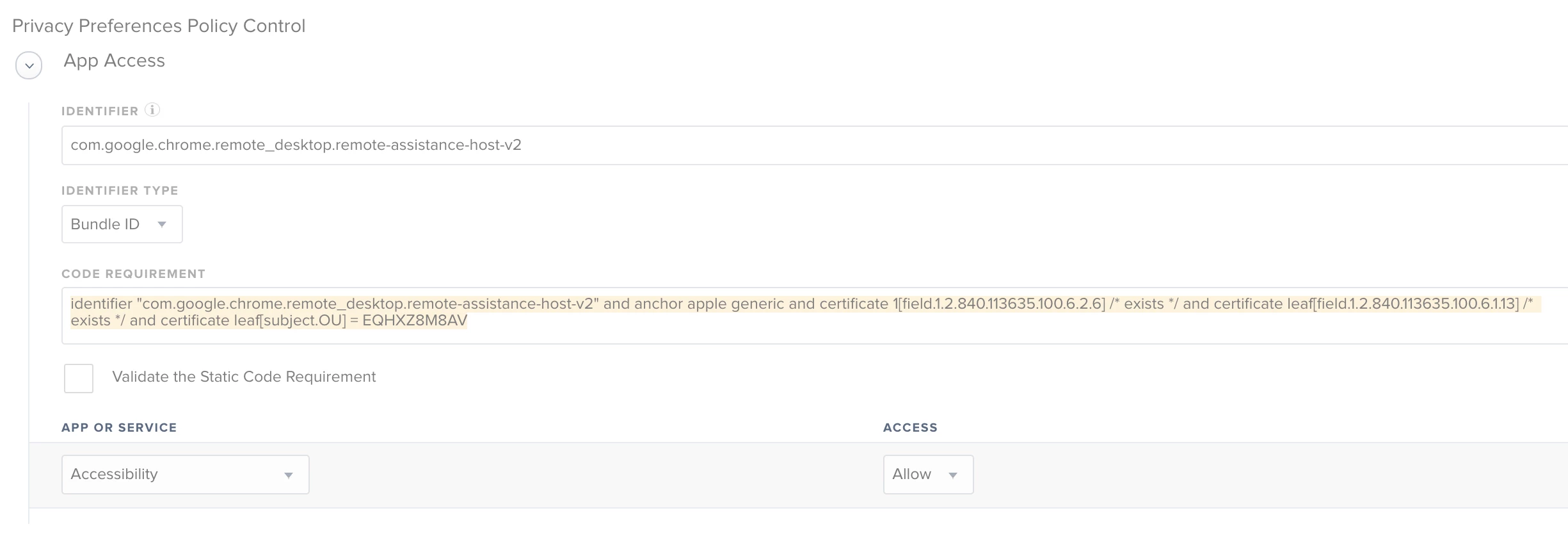

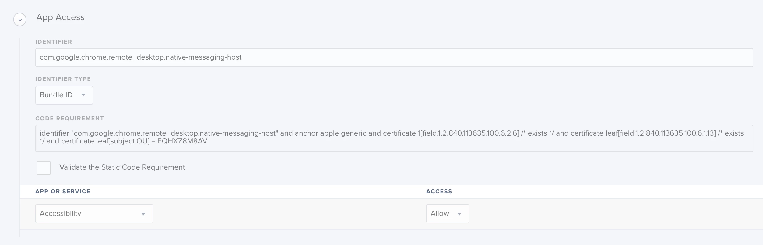

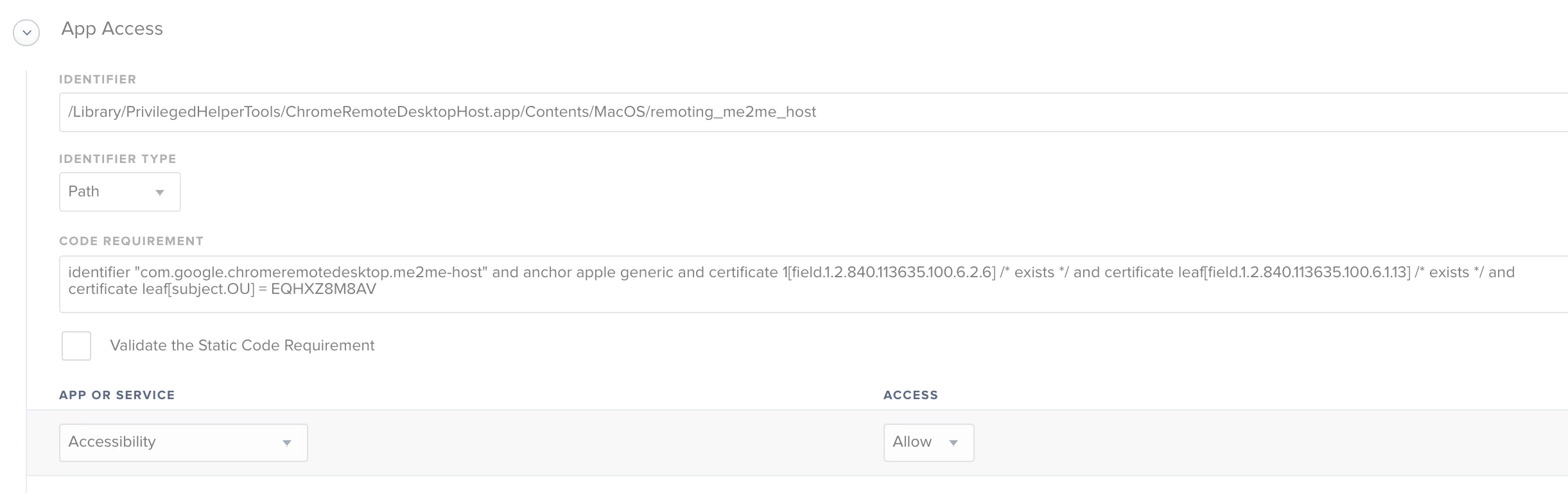

We ended up getting things to work correctly with three App Access items added to the PPPC payload:
I had no luck either. Tried the same steps provided by @jsquires3 with PPPC utility. The checkbox is still unchecked.
