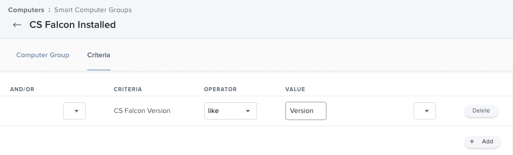

This is the EA that I use to pull the CS version. It is named CS Falcon Version. I then have a Smart Group called CS Falcon Installed keyed on that EA and looking for the word "version".

hey @tomt how did you get CS in the criteria section?
@Anton That's the title of my EA.
