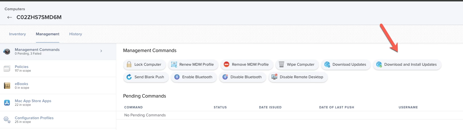

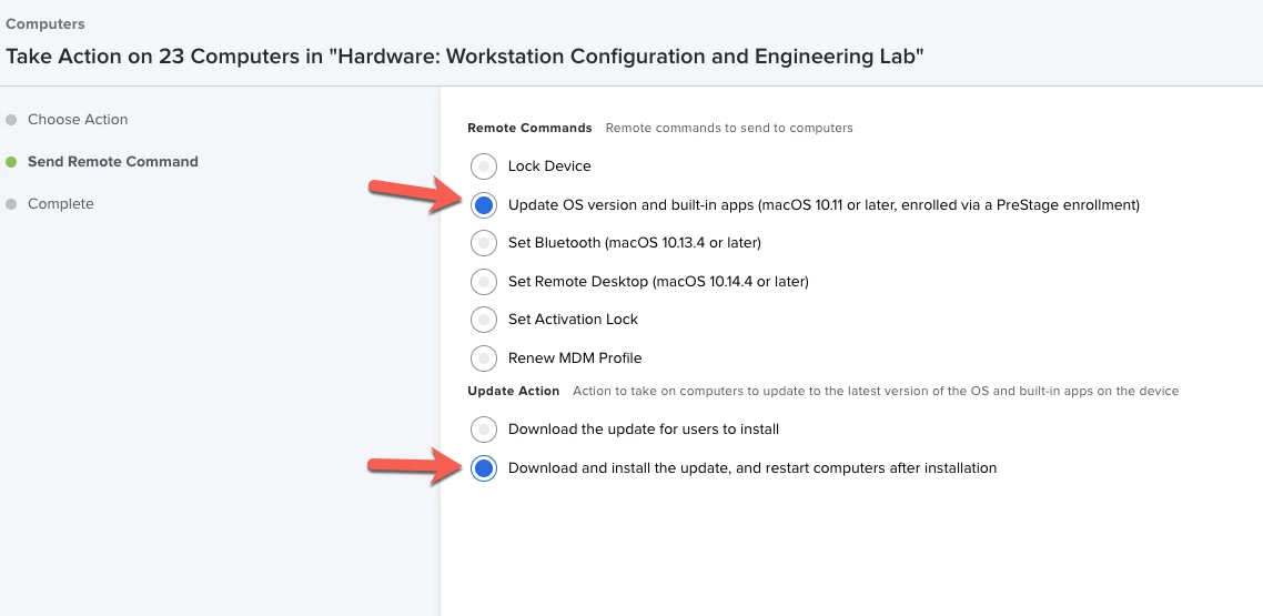

Unfortunately I cannot stress enough how poorly Apple has designed the software update function in macOS and how insistent JAMF is at avoiding doing anything with it.
Softwareupdate uses a Bootstrap Token to approve the updates to be installed and reboot the device (if you use -R and if needed). Starting with M1 (Apple Silicon) Apple no longer allows the use of a Bootstrap Token to install updates, Apple requires the use of a Secure Token. A Secure Token comes from a user, so if you run Softwareupdate -aiR on an Apple Silicon Mac the user will get a popup to enter credentials to provide that Secure Token to install updates. If they input bad credentials or cancel the box updates wont install. This is a departure from the behavior on Intel Macs where updates just install.
Apple is Moving to Management Commands to hand software updates, this requires management/supervision and DEP if I am not mistaken of the device and you see the option within the management tab on the inventory record if the Mac has available updates. You can do mass updates off of computer groups and this works for Apple Silicon and Intel Macs.
Its not all rosy though. Apple has that management command barely fleshed out. Extremely limited user notification, no deferral (until Monterey), absolutely no reporting or logging in JAMF as its a management command. Basically you have no idea if the updates seceded or failed. When you tell them to run the Mac will run them when it gets the command and it reboots without warning the user when ready. If a Mac is turned of it will get the command when it comes online even if that is days later. Basically Apple killed a poorly designed but working method with Softwareupdate with an incomplete product that is the Management Command.
In sort look in to running software updates from the management command for minimal interaction, and do some research on managing that management command on Monterey. I would provide more information on this but I am still figuring the Monterey stuff out myself.
Where the softwareupdate management command is located in the inventory record.
Where the softwareupdate management command is located in a search or group action.
