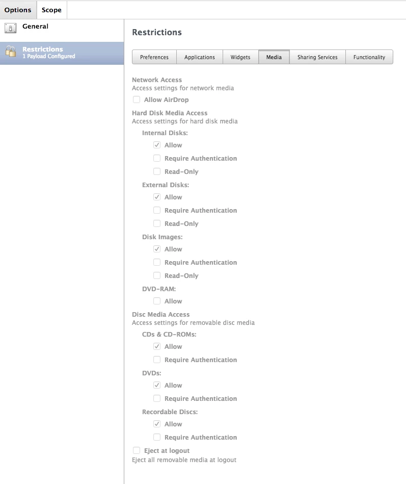

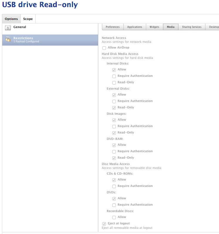

I think I found the cause of my particular problem. I had to create a Config Profile to block write access to external drives due to security requirements. This config profile in combination with our distribution points being served from Windows 2008 and 2012 servers seems to prevent DMGs from being recognized. When I disable that config profile, DMGs suddenly work again. As soon as I turn it back on, they fail. I sent the config profile to my JAMF Buddy and he verified that the problem is reproducible on his end.
Here is the profile in its entirety:
If you have anything like this setup in your system, take a look at that.

I had this issue pop up again. Found the problem. it was a configuration profile -> Restrictions -> Media.
None of these were checked marked. I checked allow for all of em and it fixed the DMG mount error.
Got the same issue, and indeed, the solution was to remove the profile then set it up properly.
Thanks everyone in the thread :)
Thanks to @tknighton, @AVmcclint, and @ant89 for your help! Disk Images was unchecked for me and it was preventing me from mounting DMGs.
