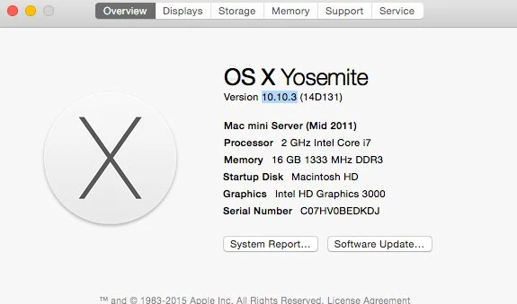

I'm seeing the same issue and it is driving me crazy. I thought it was an issue with the update to SIU but not i'm not sure. It is definitely an issue with 10.10.3/Server 4.1. I was able to build and boot to images with the new MBA13/MBP13 no problem before the release. When I upgraded my dev server to try and unfork the images now they don't boot at all. I get the black screen and it goes straight to internal disk.
Please post the following info please.
Screen shots of your mac mini about this mac where it shows OS version with build #
and double click your netboot image where it shows details and diskless.
Thanks.

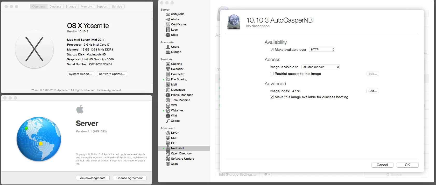

This is the AutoCasperNBI that I have created from a AutoDMG image that was created today based on 10.10.3 installer app that was downloaded today

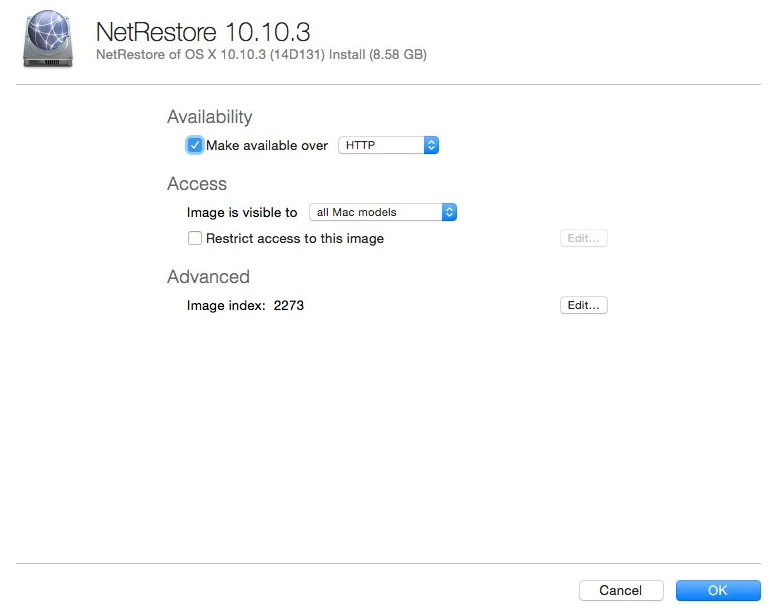

This is the NetRestore that I created today with SIU from the same 10.10.3 installer app
In the about this mac click on where is says 10.10.3 it should show a build # something like (15D141)
yep, that's what it says

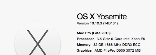

I am running 10.10.3 with Server 4.1 on a Mac Pro. With a 10.10.3 image for my MacBookAir 7,2
