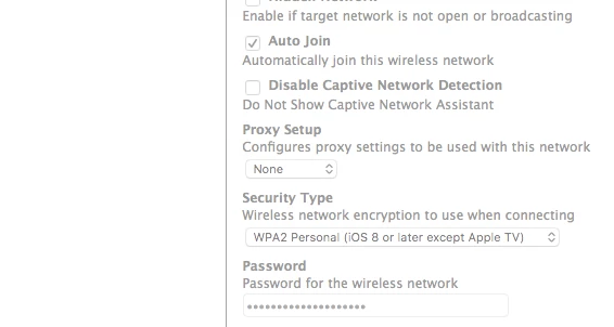

Hey, I'm Not sure if this is the same problem your having, but when I first deployed Apple TVs in my environment, they would come out of configurator/dep with wifi working profiles that I had preselected. I noticed at next checkin they would lose internet access because they were falling under a scope to deploy a WiFi profile that did not support the Apple TVs. (similar network profile created for the iOS devices). My problem ended up being the network profile that I scoped to them was not supported by the Apple TVs. In my JSS currently, I have a separate configuration profile for Apple TVs. The first profile is scoped to my iPads, the second is scoped to my apple tvs. I'm not sure if this is different in version 10.
