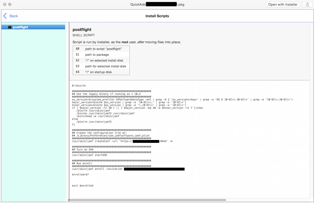

The QuickAdd...
(1) installs the /usr/local/sbin/jamf binary (used to be /usr/sbin/jamf):
(2) runs a postflight script that creates the plist to point the binary to JSS, sets SSH, and then runs the enrollment command (enforce management framework, including creating the management account, login/logout hooks, etc., etc.).
If QuickAdd fails, its usually because the postflight script fails.

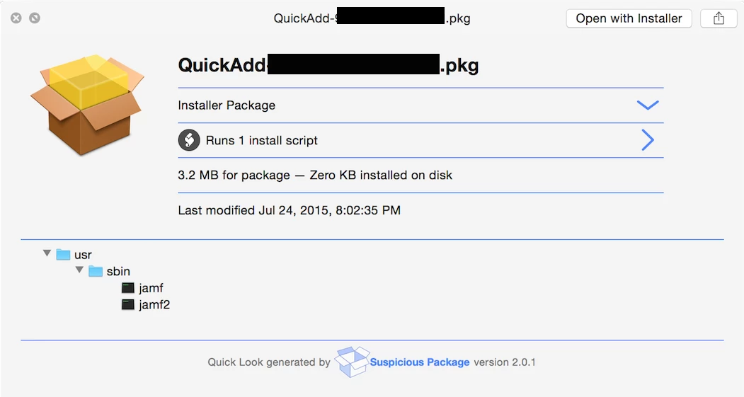

Just out of interest, are you using a web based self enrollment from https://your.jss.com:8443/enroll or a recon generated quickadd.pkg?
If time permits, I would probably pick the quickadd.pkg apart, manually deploy the files in the payload and then step through the postinstall script step by step in the terminal. That usually tells you what line it is failing on.
