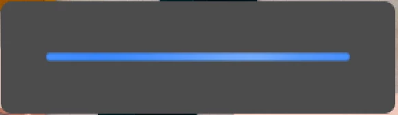

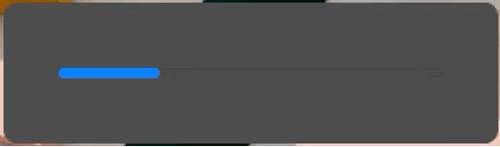

It is expected that in Catalina the "animated loading bar" is not animated and in BigSur it is?
Catalina
BigSur

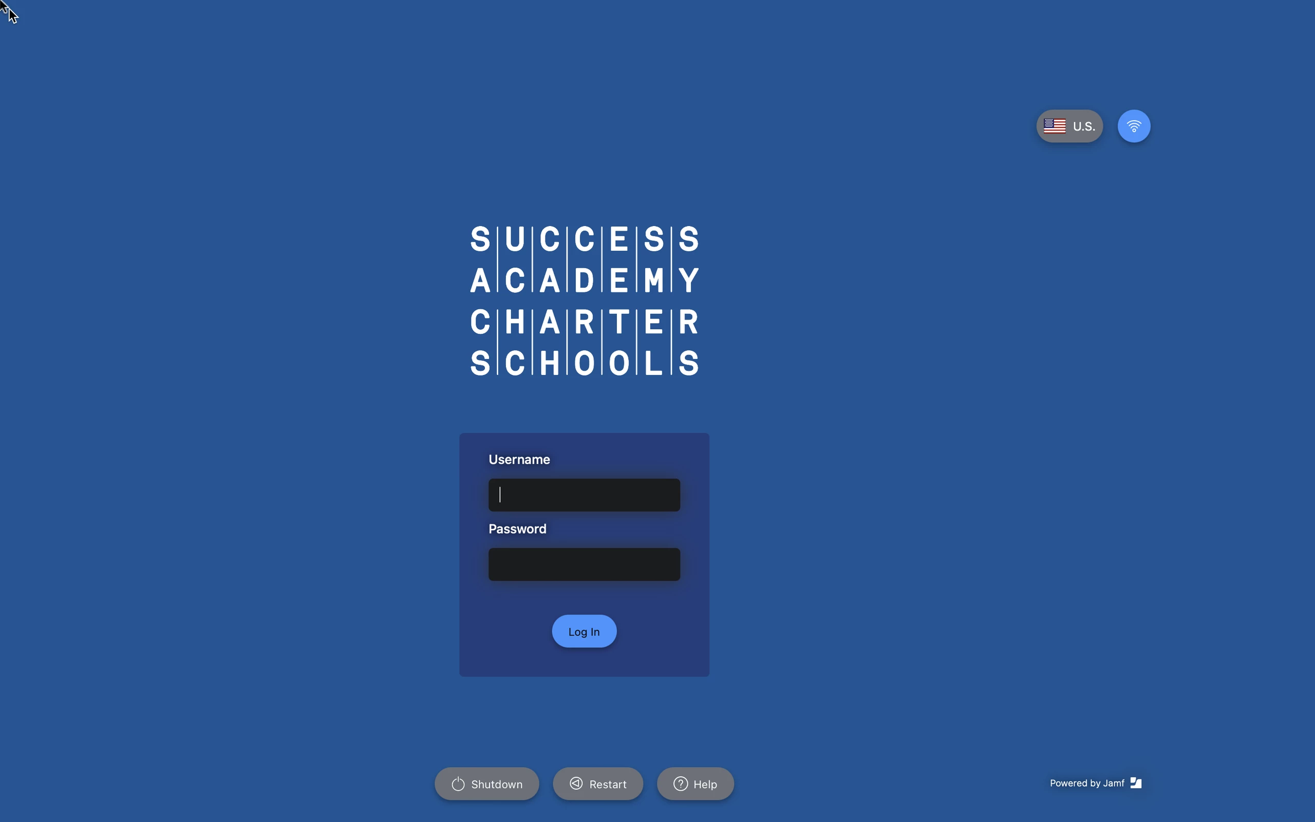

Logging out seems ok, but login window is all over the place after reboot.
Can confirm that the loading bar is a bit spotty. I logged in for the first time on a machine using an Okta Verify Push notification, and after accepting the MFA push and the loading bar animated for a few seconds, the window telling me to accept my MFA push came back up again which was very confusing. I was able to ignore it and login proceeded, but it had a "cancel" button that I could have pressed, and I have no idea if that would have interrupted anything.

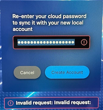

Anyone else seen this error message. Invalid Request: Invalid Request.
It happens during the initial login right after Azure successful authentication, so I know password is correct. Also it was working fine until I moved to Version 2.3.1

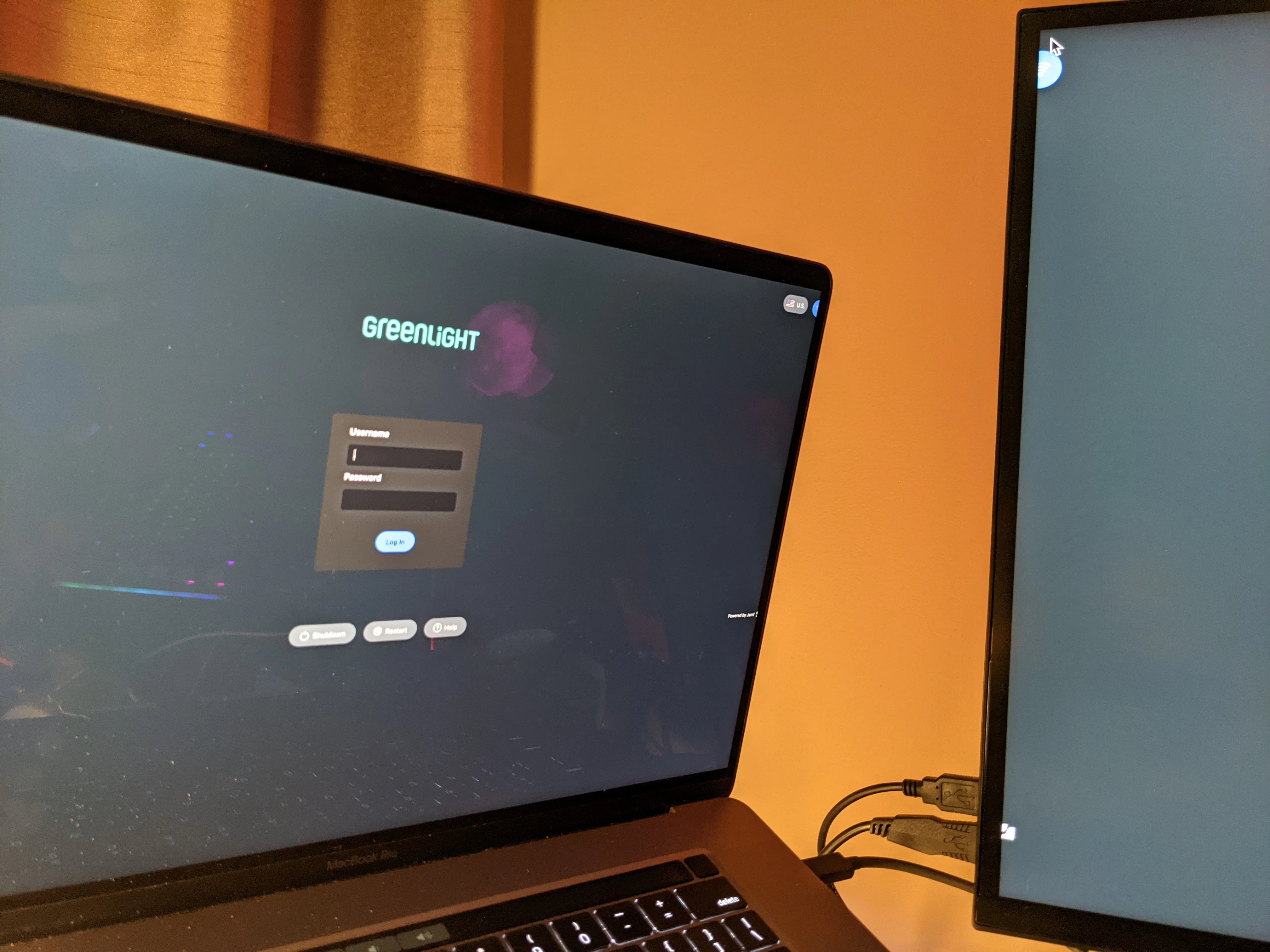

Just installed this on a test device. Is the login window expected to be horribly off-center like this...? What in the world
Jamf Connect 2.3.1 is not working for me with M1. Actually, the whole process to sign in via Google + Jamf Connect is skipped and I have instant the macOS login screen. That means, via Google SignIn the local account creations is skipped and no user login is available.

@MacLover did you ever figure out what was causing the issue for you? I am testing out 2.3.2 now and getting the same "Invalid request: Invalid Request" error that you mentioned.
@Lodavigo The Invalid request is related to: (Create a Separate Local Password) change it from false to true and that should help.
If set to true, this key prompts users to create a new password for their new local account. If set to false, this key prompts users to re-enter their network password, which also becomes the local account password. This ensures a user's network and local password are synced during user creation.
@Flaurian would love to know how that works for you! I had to add in a authchanger reset command after and then a reboot to get it to work properly.
@user-knjgIBMpIx JC2.3.2 works fine for me without any autochanger changes 🙂
Hi MacLover
Did you find a solution for this?
Hi MacLover
The Invalid request in my case is related to: Create a Separate Local Password. I changed it from false to true and that solved it for us for now. We have to enter password twice but at least it works.
Thank you! That saved a lot of time.
