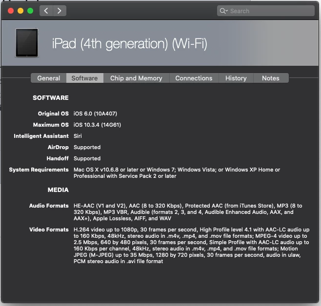

Hope this helps!
MacTracker is a great tool for this!

@jharrell Given that these are iPad 4's that don't support anything beyond iOS 10 you're probably not going to see too many app updates on these. Often app updates need a newer OS version as they utilize new or updated API's not available in iOS 10.
If the world puts itself back together eventually my suggestion is to start searching for funding to get however many you have of that particular model replaced with a newer one. If they're in decent physical shape then you can also send them to someplace like Diamond Assets, SecondLifeMac, etc.. for buyback.
@mainelysteve is correct. 10.3.3 is max on those models. There is a physical RAM limitation that prevents it from further upgrading.
